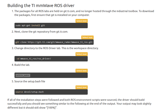

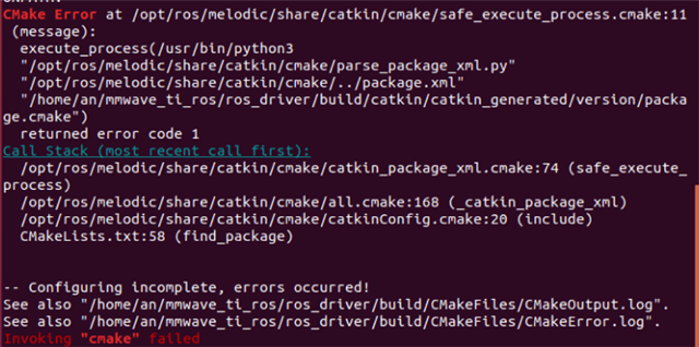

我根据下图的Ti mmWave MMW ROS Driver User Guide尝试进行可视化数据,
在执行到"build the lab"这步,也就是执行"catkin_make"时
,会出现错误
,请问这是什么原因,并且如何解决

This seems to be an issue with the your current ROS setup and the Python installed on your computer. ROS Melodic/Noetic does not seem to like python3, and so this does not seem to be a mmWave Sensor or its ROS driver related issue. Check here:
https://answers.ros.org/question/346359/cmake-error-at-optrossafe_execute_processcmake/
