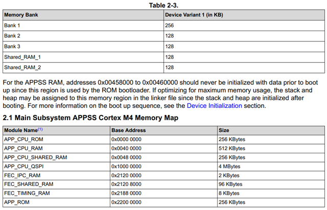

2. In the document AWRL6432 reference manual, Section 2.1,Main Subsystem APPSS Cortex M4 Memory Map, Is there any more detailed information to explain this?

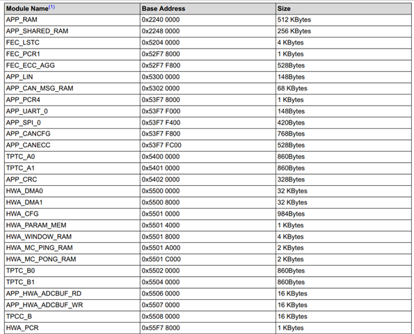

3. What memory addresses can EDMA access? I tried, but the address 0x00400000 is not accessible by EDMA, but 0x22400000 is.

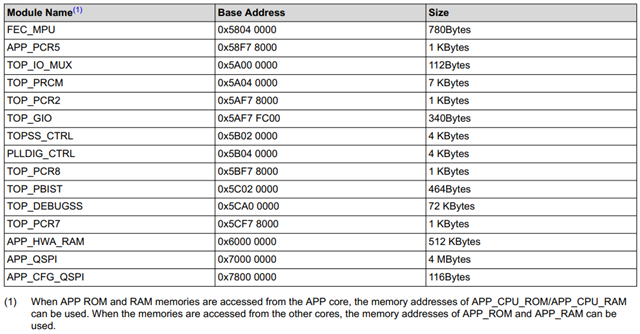

    1. In  2.1 Main Subsystem APPSS Cortex M4 Memory Map,   APP_CPU_ROM, APP_CPU_RAM, APP_CPU_SHARED_RAM, APP_RAM, APP_SHARED_RAM, APP_ROM, APP_HWA_RAM, etc., what are the roles of these memory, and what are the differences?

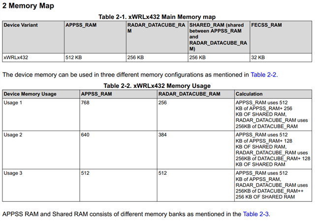

    2. The ram size of the chip 6432 is 1MBytes. According to Table 2-1, it consists of APPSS_RAM, RADAR_DATACUBE_RAM, and SHARED_RAM. Which memory region does APPSS_RAM, RADAR_DATACUBE_RAM, SHARE_RAM correspond to?

    I have some understanding: APP_CPU_RAM, ROM, SHARED_RAM can only be accessed by the CPU, except for the CPU, other can not be accessed, is this understanding correct?
    Also, what does APP_RAM, ROM, SHARED_RAM have to do with APP_CPU_RAM, ROM, SHARED_RAM? Is the APP's memory loaded into the APP_CPU during initialization? If both can be used at the same time, then why does the manual mention that APPSS_RAM size is 512KB? APP_RAM + APP_CPU_RAM = 1024KB

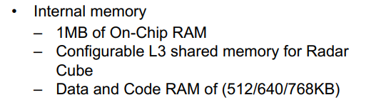

    What memory does 1MB of On-Chip RAM contain that is mentioned in the RM documentation?
    And Configurable L3 shared memory for Radar Cube、 Data and Code RAM of (512/640/768KB)?
  • Hello,
    In the AWRL6432 datasheet and reference manual, the 1MB of On-Chip RAM likely refers to the total amount of random access memory (RAM) available on the chip for various purposes such as data storage, program execution, and other system operations.
    The Configurable L3 shared memory for Radar Cube, Data, and Code RAM (512/640/768KB) likely refers to a specific portion of the on-chip RAM that can be allocated and configured for different purposes, such as storing radar data, code, and other data. The specific allocation size (512/640/768KB) may indicate the flexibility in how this shared memory can be partitioned for different functions.
