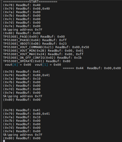

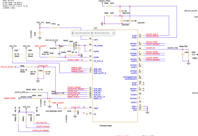

         附件是我的驱动文件及驱动log。我目前只使用了A通道的三相,我阅读芯片手册,需要先选择page,然后设置VOUT_COMMAND, 使能OPERATION,之后还有别的操作吗,并没有电压输出, 其他的寄存器在芯片手册中都有默认值,如 VOUT_MODE 只读 且设置为5mv,ON_OFF_CONFIG 默认设备1B,PHASE默认为FF,我不知道还需要设置那些寄存器,

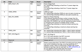

int parse_status_mfr_specific(uint8_t addr)
  uint8_t status = 0;
  read_from_reg(addr, &status, 1);
  printf("MFR_SPECIFIC_STATUS: 0x%02X\n", status);
  // Bit7: MFR_FAULT_PS (Power stage fault - latched)
  if (status & MFR_FAULT_PS_MASK)
    printf("- Bit7 (MFR_FAULT_PS): Power stage fault detected (latched).\n");
  // Bit6: VSNS_OPEN (VSNS pin open - latched)
  if (status & VSNS_OPEN_MASK)
    printf("- Bit6 (VSNS_OPEN): VSNS pin open detected (latched)\n");
  // Bit5: MAX_PH_WARN (Max phase warning - latched)
  if (status & MAX_PH_WARN_MASK)
    printf("- Bit5 (MAX_PH_WARN): Max phase count exceeded (latched).\n");
  // Bit4: TSNS_LOW (TSEN ≥ 150mV before soft start)
  if (status & TSNS_LOW_MASK)
    printf("- Bit4 (TSNS_LOW): TSEN voltage high before soft start.\n");
  // Bit3: RST_VID (VID reset occurred)
  if (status & RST_VID_MASK)
    printf("- Bit3 (RST_VID): VID reset executed (Page 0 only).\n");
  // Bit2~1: Reserved (should be 0)
  if ((status & 0x06) != 0)
    printf("- Bit2~1: Reserved bits set unexpectedly (0x%02X).\n", status & 0x06);
  // Bit0: PHFLT (Phase current sharing fault - latched)
  if (status & PHFLT_MASK)
    printf("- Bit0 (PHFLT): Phase current sharing fault detected (latched).\n");
  return 0;

status_byte: not providing power to VOUT: 41
status_byte: Unclassified fault (e.g., UVF, OCW; check other status registers)
status_word: value: 0x1841 (Bytes: 0x41 0x18)
status_word: MFR bit warning
status_word: Power NOT good (AVR_RDY/BVR_RDY pin is LOW)
status_word: Not providing power to VOUT
status_word: Unclassified fault detected
MFR_SPECIFIC_STATUS: 0x40
 vout[0] = 0x00  vout[1] = 0x00

  • 您好,这个驱动思路有问题吗,这是芯片的电路图
  • 尊敬的技术工作者:
    经过我们仔细研读芯片手册,我们的电路设置存在问题,如数据表所示,BCSP1接到GND, BCSP2接到3.3V, BVSP/BVSN都绑到GND,同时将ACSP4 接到V3P3,以此修复电路,后续日志调试如下:
    ==============START==========
    (0x78) ReadBuf: 0x41
    (0x79) ReadBuf: 0x18,0x41
    (0x7a) ReadBuf: 0x00
    (0x7b) ReadBuf: 0x00
    (0x7c) ReadBuf: 0x00
    (0x7d) ReadBuf: 0x00
    (0x7e) ReadBuf: 0x00
    (0x80) ReadBuf: 0x40
    TPS53681_PAGE(0x00) ReadBuf: 0x00
    TPS53681_PHASE(0x04) ReadBuf: 0xff
    TPS53681_VBOOT(0xDB) ReadBuf: 0x23
    TPS53681_VOUT_COMMAND(0x21) ReadBuf: 0x00,0x23
    TPS53681_VOUT_MIN(0x2B) ReadBuf: 0x00, 0x1d
    TPS53681_VOUT_MAX(0x24) ReadBuf: 0x00, 0xff
    TPS53681_ON_OFF_CONFIG(0x02) ReadBuf: 0x1b
    TPS53681_OPERATE(0x01) ReadBuf: 0x80
    Skipping address 0x7F
    从寄存器79的值来看,bit12和bit11 存在问题,根据bit12 找到寄存器80的VSNS_OPEN,同时VSNS_OPEN指的是芯片那些io,在正常输出的情况下P_GOOD、VSNS_OPEN值是什么或者 这两个值受到什么影响 谢谢!
    参考连接Linux/TPS53681: TPS53681: No output voltage - Power management forum - Power management - TI E2E support forums
  • PGood镜像AVR_Ready,在正常情况下为3v。对于Reg 80h,这取决于状态,请参阅TRM的截图。
  • 您好!已收到了,后续我们 调整了电路,但是代码配置还是报错,代码如下,希望你们帮忙看下软件寄存器配置有无错误,这样我们把精力放在硬件电路的上,方便我们排查问题和日志输出,请您尽快答复吧 谢谢您

  • 尊敬的技术工作者:
            上面的问题是我们硬件电路存在问题,我们修改电路, 现在已经没问题了, 谢谢您的这些支持
