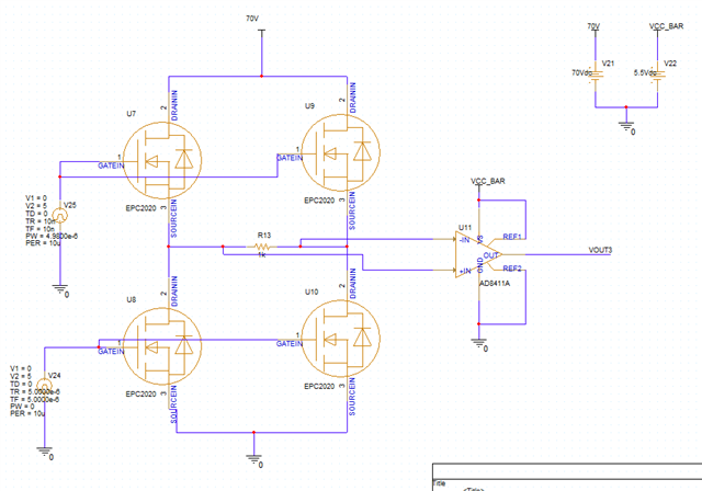

PSPICEFORTI 出现一大推错误,是模型 的问题还是哪的问题,有办法解决吗?

X_U11.BIbiasP X_U11.N027 0 X_U11.I X_U11.IF V
ERROR(ORPSIM-16147): Invalid parameter
+ 3 0 0 V 7 0 0 0e-6 104e-6
X_U11.BIbiasN X_U11.N006 0 X_U11.I X_U11.IF V

X_U11.BSL1 0 X_U11.VSL_OUTP X_U11.I X_U11.limit 1*V VSL_INP
+ VSL_OUTP 0.4 -0.4

X_U11.Rout X_U11.VVO VOUT3 0.2 Noiseless
ERROR(ORPSIM-16015): Unknown parameter.

X_U11.B1 X_U11.Satp X_U11.VSx X_U11.I X_U11.1m*Dnlim Ap
+ + Bp*V Vimon 2 +Cp*V Vimon 2 **2 Ap 1m

.model X_U11.DO D Vfwd
ERROR -- 'Vfwd' is not a model parameter name
ERROR(ORPSIM-15113): Model IF used by X_U11.BIbiasP is undefined
ERROR(ORPSIM-15113): Model IF used by X_U11.BIbiasN is undefined
ERROR(ORPSIM-15113): Model limit used by X_U11.BSL1 is undefined
ERROR(ORPSIM-15113): Model limit used by X_U11.BSL2 is undefined
ERROR(ORPSIM-15113): Model 1m*Dnlim used by X_U11.B1 is undefined
ERROR(ORPSIM-15113): Model 1m*Dnlim used by X_U11.B2 is undefined
ERROR(ORPSIM-15113): Model 1m*I used by X_U11.B3 is undefined
