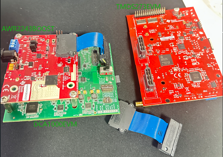

Can AWR2243BOOST + TMDS273EVM alone perform both real-time point cloud visualization and raw ADC data capture at the same time?
Is it possible to cascade TMDS273EVM and DCA1000EVM together with an AWR224BOOST board to achieve both functionalities?
If cascading is not supported, can I use two AWR2243BOOST boards—one with DCA1000EVM for ADC capture and the other with TMDS273EVM for point cloud visualization?
Is there any official Quick Start Guide for using AWR2243BOOST + TMDS273EVM? If not, could you please give a brief instruction on how I should connect them?

For Q1 &Q2, Pls refer to mmw demo in MCUplus SDK, https://dr-download.ti.com/software-development/software-development-kit-sdk/MD-U4MY7aGNn5/04.06.01.02/mmwave_mcuplus_sdk_04_06_01_02-Windows-x86-Install.exeIf cascading is not supported, can I use two AWR2243BOOST boards—one with DCA1000EVM for ADC capture and the other with TMDS273EVM for point cloud visualization?
If you wish to cascading 2 AWR2243 to achieve 6T8R simutaneously, you will need TIDA-020047 hardware to capture ADC data or get point cloud, if using 2 AWR2243BOOST, they can not share the LO or any other sycn signals.Is there any official Quick Start Guide for using AWR2243BOOST + TMDS273EVM? If not, could you please give a brief instruction on how I should connect them?

For Q3:
As per your previous reply, you mentioned that the TIDA-020047 hardware is required to simultaneously capture ADC data and obtain point cloud data. However, this hardware isn't available for sale from TI. Therefore, I'm planning to use two separate setups at the same location: one AWR2243BOOST board cascaded with the TMDS273EVM for point cloud visualization, and another AWR2243BOOST cascaded with the DCA1000EVM for ADC data capture. My primary concern is whether cascading the AWR2243BOOST with the TMDS273EVM alone is feasible. If this is possible, could you please guide me on how to properly cascade and operate these two devices safely, especially regarding connections for power and data cables? I'm concerned about potentially damaging the hardware due to incorrect connections.

1,AM273x Evaluation Module User's Guide (Rev. D) pls refer to chapter 2.4, Pls only power AM2732 and connect the uart of AM2732 for debug and evaluation.
2. for Demo instruction pls down load SDK 4.4.0.1 https://dr-download.ti.com/software-development/software-development-kit-sdk/MD-U4MY7aGNn5/04.04.00.01/mmwave_mcuplus_sdk_04_04_00_01-Windows-x86-Install.exe
and refer to SDK user guide in this path mmwave_mcuplus_sdk_04_04_00_01\mmwave_mcuplus_sdk_04_04_00_01\docs.
