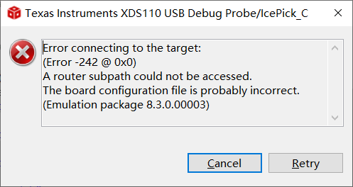

仿真器报错:
A router subpath could not be accessed.
The board configuration file is probably incorrect.

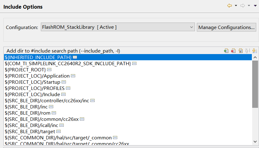

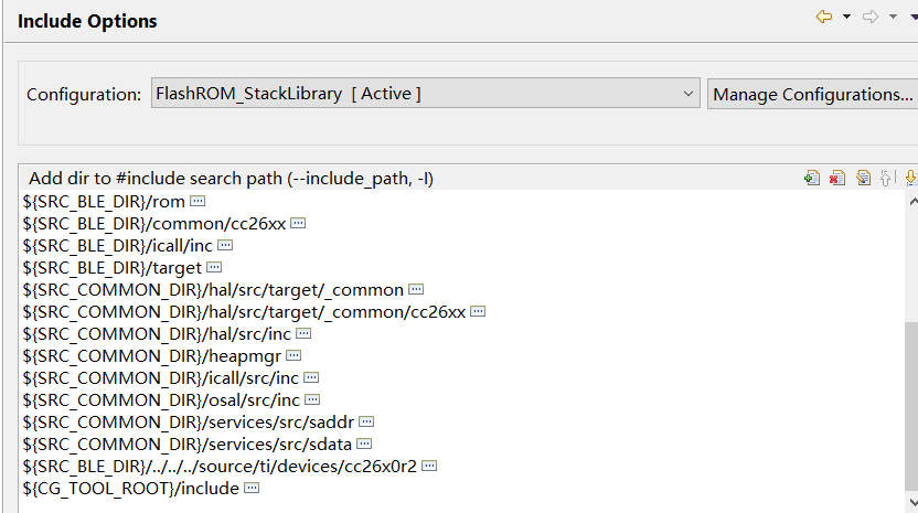

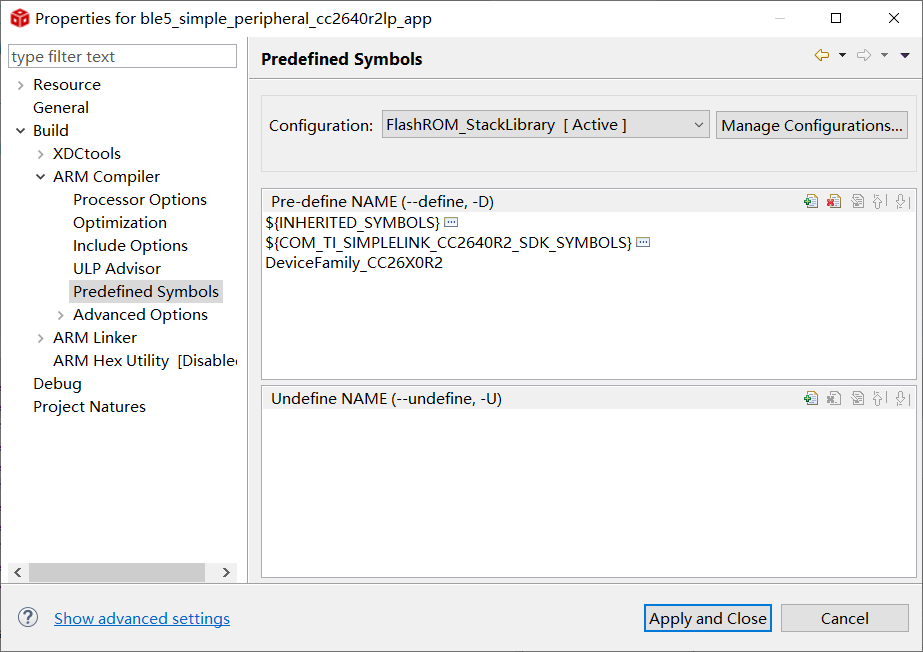

默认predefined宏:
include options:
