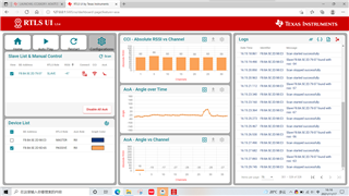

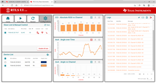

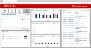

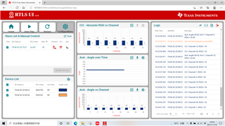

为什么我使用了option2的去看UI界面passive怎么就不显示了?我昨天试的时候是显示的 今天怎么就不显示了?
测试场地应远离墙面,柱子,以及光滑的表面
It is recommended to evaluate the RTLS solution in an area that optimizes RF conditions. This includes:
- An open space with no large metal or concrete obstructions (pillars, poles, etc.)
- Relatively few interference sources (i.e. Wi-Fi access points, etc.)
- Raised platforms for the nodes made out of cardboard ~1 m off the ground.
如在光滑的桌面上测试,可以在下面垫上硬纸板
另外由于passive设备未与直接slave建立连接,而是监听master然后获得采样数据,所以不稳定,你只可以使用仅central测量
或者不用ui,用Running the RTLS Non-Visual Demo导出数据看一下:https://dev.ti.com/tirex/explore/node?a=pTTHBmu__5.10.00.48&node=AHYhhuDNTaRXzkOlahOlvA__pTTHBmu__5.10.00.48&r=pTTHBmu__LATEST
