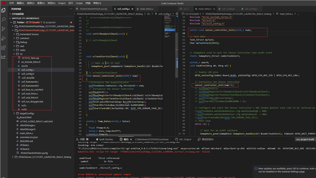

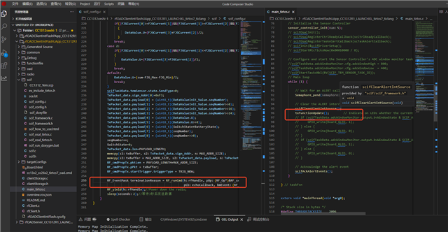

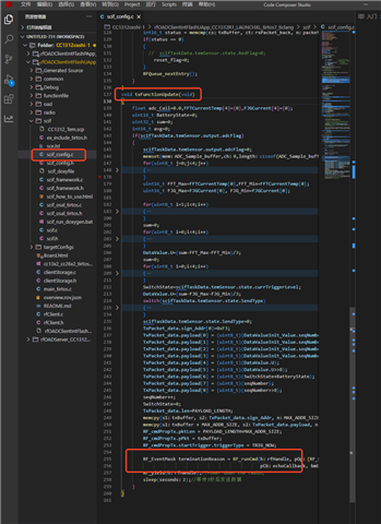

    我遇到的问题是,我开了两个线程将OAD的rfOADClientIntFlashUapp程序保持不动,将我的功能加入到新开的线程里面去,程序根本无法运行,运行到Event_pend或者Semaphore_pend就会死机重启;我有尝试将两个功能放在一个线程里面,Event_pend和Semaphore_pend放在一起,算是一前一后这样也会死机然后重启。根本无法运行
    我最终需要实现的目的是:
    1、超低功耗的前提下,将小核sensor采集数据,并切定时唤醒大核,让大核计算并发送出去。
    2、实现应用程序可以使用SUB1G进行更新(升级)这样无需接触无需拆壳,在无需升级时只需等待尽可能不要提高功耗。
    因为详细查阅过 rfOADClientIntFlashUapp 的使用方法目前已经基本了解,但是现在将我需要的功能移植到 rfOADClientIntFlashUapp 遇到了问题,只要加入Semaphore_pend整个程序就会死机。尚未查到具体什么原因。为了避免表达有误以下是我已经实现的功能的代码,需要一直到 rfOADClientIntFlashUapp程序里面去。

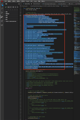

    void *mainThread(void *arg0)
    create_sin_tab(CREATE_SIN_TAB,32);
    Timer_Params params;
    RF_Params_init(&rfParams);
    if(RFQueue_defineQueue(&dataQueue,
    rxDataEntryBuffer,
    sizeof(rxDataEntryBuffer),
    NUM_DATA_ENTRIES,
    PAYLOAD_LENGTH + NUM_APPENDED_BYTES))
    /* Failed to allocate space for all data entries */
    while(1);
    /* Modify CMD_PROP_TX and CMD_PROP_RX commands for application needs */
    RF_cmdPropTx.pktLen = PAYLOAD_LENGTH;
    RF_cmdPropTx.pPkt = txBuffer;
    RF_cmdPropTx.startTrigger.triggerType = TRIG_NOW;//TRIG_ABSTIME;
    RF_cmdPropTx.startTrigger.pastTrig = 1;
    RF_cmdPropTx.startTime = 0;
    RF_cmdPropTx.pNextOp = (rfc_radioOp_t *)&RF_cmdPropRx;
    /* Only run the RX command if TX is successful */
    RF_cmdPropTx.condition.rule = COND_STOP_ON_FALSE;
    /* Set the Data Entity queue for received data */
    RF_cmdPropRx.pQueue = &dataQueue;
    /* Discard ignored packets from Rx queue */
    RF_cmdPropRx.rxConf.bAutoFlushIgnored = 1;
    /* Discard packets with CRC error from Rx queue */
    RF_cmdPropRx.rxConf.bAutoFlushCrcErr = 1;
    /* Implement packet length filtering to avoid PROP_ERROR_RXBUF */
    RF_cmdPropRx.maxPktLen = 5;//PAYLOAD_LENGTH-5;
    RF_cmdPropRx.pktConf.bRepeatOk = 0;
    RF_cmdPropRx.pktConf.bRepeatNok = 0;
    RF_cmdPropRx.pOutput = (uint8_t *)&rxStatistics;
    /* Receive operation will end RX_TIMEOUT ms after command starts */
    RF_cmdPropRx.endTrigger.triggerType = TRIG_REL_PREVEND;
    RF_cmdPropRx.endTime = RX_TIMEOUT;
    rfHandle = RF_open(&rfObject, &RF_prop, (RF_RadioSetup*)&RF_cmdPropRadioDivSetup, &rfParams);
    /* Set the frequency */
    RF_postCmd(rfHandle, (RF_Op*)&RF_cmdFs, RF_PriorityNormal, NULL, 0);
    RF_yield(rfHandle);
    sleep(2);
    sensor_controller_init(COLLECT_TIMER);
    while(1)
    Semaphore_pend(Semaphore_handle(&semScTaskAlert), BIOS_WAIT_FOREVER);
    txFunctionUpdate();//该函数内仅包含计算sensor采集的数据以及使用RF_runCmd函数发送的相关代码
    /* Power down the radio */
    //RF_yield(rfHandle);
    scifAckAlertEvents();

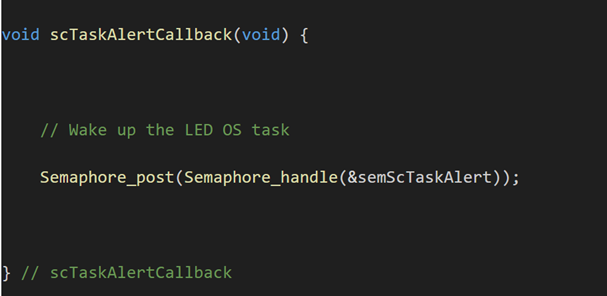

        请注意,需要从 scTaskAlerCallback 中调用 Semaphore_post。
  • Semaphore_post只能从 scTaskAlerCallback 中调用么?否者不能实现?
    如果将Semaphore_post放在scTaskAlerCallback里面,主函数while(1){}里面应该怎么阻塞才能低功耗
  • 您好,
      是的,Semaphore_post 应该放在 scTaskAlerCallback 内,因为这是当传感器控制器唤醒主核时执行的回调函数。
