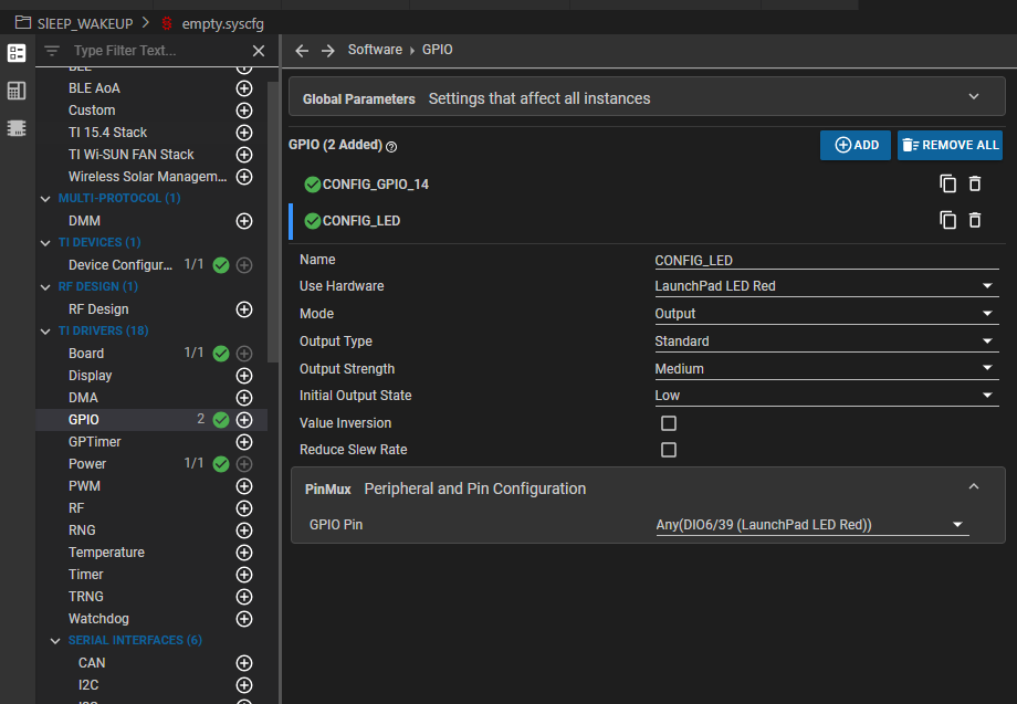

CC1352P: CC1352P1 LaunchPad 进入standby后无法用按键唤醒
Part Number: CC1352P
代码仅做最简进入standby后按键唤醒,测试用外部供电仅能进入休眠,无法唤醒,调试器供电也一样,有没有大佬知道怎么解决

  • 您好
    已经收到了您的案例,调查需要些时间,感谢您的耐心等待
  • 您好
    客户在使用该示例时遇到相同问题吗?: gpiointerrupt
  • 你好,我用示例测试了,可以正常控制亮灭,只是没有消抖会有一些抖动现象

  • 您好
    Do you mean that you are seeing bouncing behavior on the buttons?
  • Yes, sometimes when the button is pressed, the LED will turn on and off multiple times.
  • 您好
    Is the customer still seeing the issue if he enables hystereris in the example by modifying line 81 ?
      GPIO_setConfig(CONFIG_GPIO_BUTTON_0, GPIO_CFG_IN_PU | GPIO_CFG_IN_INT_FALLING | GPIO_CFG_HYSTERESIS_ON);
