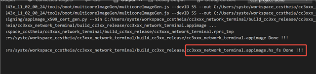

  • 1、The compilation is complete, generating cc3xxx_network_terminal.apimage.hs_fs
    2、We are using a secure method, do you want me to try another way? I can try this.
    3、Did not forget to add the application in the script.This is the program_application_and_wifi_fw.cfg script that I am using.

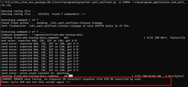

  • I tried running the script in non secure mode twice, but encountered an error. The error is as follows,This is the program_application_and_wifi_fw.cfg script.
    #      DEFAULT CONFIGURATION FILE TO BE USED WITH THE FLASHWRITER SCRIPT      #
    # By default this config file,
    # - points to pre-built flash writer, bootloader for this LP
    # - The application image points to relative path of the ipc echo application image for this LP
    #   - Make sure this application is built before running this script
    # - You can customized this config file to point to your own bootloader and/or application images
    # - You can use --operation=flashverify if you just want to verify the flash contents and not flash the file.
    # --flash-writer=./sbl_uart_uniflash.release.tiimage
    # First point to sbl_uart_uniflash binary, which function's as a server to flash one or more files
    # Now send one or more files to flash or flashverify as needed. The order of sending files does not matter
    # Program the OSPI PHY tuning attack vector
    --operation=flash-phy-tuning-data
    # --file=./sbl_ospi.release.tiimage --operation=flash --flash-offset=0x0
    # When sending bootloader make sure to flash at offset 0x0. ROM expects bootloader at offset 0x0
    #Network Terminal appimage file (cc3xxx_network_terminal.appimage)
    --file=./cc3xxx_network_terminal.appimage --operation=flash --flash-offset=0x80000
    #Wifi FW container (cc33xx_fw.bin)
    --file=../wifi_fw/cc33xx_fw.bin --operation=flash --flash-offset=0x800000
    #Wifi RAM Bootloafer container (cc33xx_2nd_loader.bin)
    --file=../wifi_fw/cc33xx_2nd_loader.bin --operation=flash --flash-offset=0x900000
    #cc33xx Conf configurations file (cc33xx-conf.bin)
    --file=../wifi_fw/cc33xx-conf.bin --operation=flash --flash-offset=0xa00000

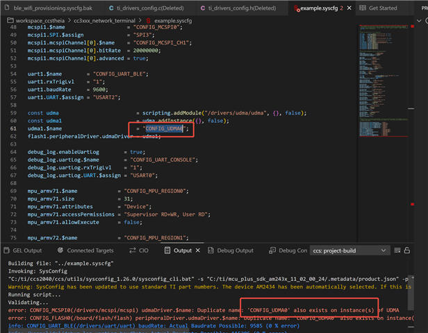

  • Starting to compile cc3xxx_network_terminal, there was an error in the example. syscfg file. Later, I used the SysConfig GUI tool to make some changes, but I'm not sure if the changes were correct. This is the modified example. syscfg file.

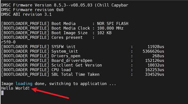

    In this case you probably have the secured version.
    The fact that the application does not load is not related to the BP itself as the Wi-Fi is not even started.
    Can you show the actual execution of the secured script?
    Also, did you make any changes to the network_terminal example?
    What I would do to make sure whether it is an AM243 issue or something else, is use the basic hello_world example from the core SDK of AM243.
    I imported it to my workspace from C:\ti\mcu_plus_sdk_am243x_08_05_00_24\examples\hello_world, compiled and got hello_world_am243x-lp_r5fss0-0_freertos_ti-arm-clang.appimage.
    After flashing and rebooting, I got the following:
    DMSC Firmware Version 8.5.3--v08.05.03 (Chill Capybar
    DMSC Firmware revision 0x8
    DMSC ABI revision 3.1
    [BOOTLOADER_PROFILE] Boot Media       : NOR SPI FLASH
    [BOOTLOADER_PROFILE] Boot Media Clock : 100.000 MHz
    [BOOTLOADER_PROFILE] Boot Image Size  : 55 KB
    [BOOTLOADER_PROFILE] Cores present    :
    r5f0-0
    [BOOTLOADER PROFILE] SYSFW init                       :      10850us
    [BOOTLOADER PROFILE] System_init                      :    5367700us
    [BOOTLOADER PROFILE] Drivers_open                     :        268us
    [BOOTLOADER PROFILE] Board_driversOpen                :     156544us
    [BOOTLOADER PROFILE] Sciclient Get Version            :      10023us
    [BOOTLOADER PROFILE] CPU load                         :       1620us
    [BOOTLOADER_PROFILE] SBL Total Time Taken             :     178301us
    Image loading done, switching to application ...
    Hello World!
    Please do the same and let me know if you see it.
  • 1. The actual execution of the script is as follows:
    This is the program_application_and_wifi_fw.cfg script and uart_uniflash.py python script that I am using.
    --flash-writer=./sbl_uart_uniflash.release.hs_fs.tiimage
    --file=./sbl_ospi.release.hs_fs.tiimage --operation=flash --flash-offset=0x0
    #Network Terminal appimage file (cc3xxx_network_terminal.appimage.hs_fs)
    --file=./cc3xxx_network_terminal.appimage.hs_fs --operation=flash --flash-offset=0x80000

    2. When compiling the cc3xxx_network_terminal there was an error in the example. syscfg file, the example. syscfg file was modified.Later, I used the SysConfig GUI tool to make some changes, but I'm not sure if the changes were correct. This is the modified example. syscfg file.
     * These arguments were used when this file was generated. They will be automatically applied on subsequent loads
     * via the GUI or CLI. Run CLI with '--help' for additional information on how to override these arguments.
     * @cliArgs --device "AM243x_ALX_beta" --part "ALX" --package "ALX" --context "r5fss0-0" --product "MCU_PLUS_SDK_AM243x@11.02.00"
     * @v2CliArgs --device "AM2434" --package "FCCSP (ALX)" --variant "AM2434-E" --context "r5fss0-0" --product "MCU_PLUS_SDK_AM243x@11.02.00"
     * @versions {"tool":"1.26.1+4441"}
     * Import the modules used in this configuration.
    const flash      = scripting.addModule("/board/flash/flash", {}, false);
    const flash1     = flash.addInstance();
    const gpio       = scripting.addModule("/drivers/gpio/gpio", {}, false);
    const gpio1      = gpio.addInstance();
    const gpio2      = gpio.addInstance();
    const mcspi      = scripting.addModule("/drivers/mcspi/mcspi", {}, false);
    const mcspi1     = mcspi.addInstance();
    const uart       = scripting.addModule("/drivers/uart/uart", {}, false);
    const uart1      = uart.addInstance();
    const udma       = scripting.addModule("/drivers/udma/udma", {}, false);
    const udma1      = udma.addInstance();
    const debug_log  = scripting.addModule("/kernel/dpl/debug_log");
    const mpu_armv7  = scripting.addModule("/kernel/dpl/mpu_armv7", {}, false);
    const mpu_armv71 = mpu_armv7.addInstance();
    const mpu_armv72 = mpu_armv7.addInstance();
    const mpu_armv73 = mpu_armv7.addInstance();
    const mpu_armv74 = mpu_armv7.addInstance();
    const mpu_armv75 = mpu_armv7.addInstance();
    const mpu_armv76 = mpu_armv7.addInstance();
    const mpu_armv77 = mpu_armv7.addInstance();
     * Write custom configuration values to the imported modules.
    flash1.$name                         = "CONFIG_FLASH0";
    flash1.peripheralDriver.$name        = "CONFIG_OSPI0";
    flash1.peripheralDriver.inputClkFreq = 50000000;
    flash1.peripheralDriver.dmaEnable    = true;
    flash1.peripheralDriver.child.$name  = "drivers_ospi_v0_ospi_v0_template0";
    gpio1.$name          = "WLAN_EN";
    gpio1.pinDir         = "OUTPUT";
    gpio1.rx             = true;
    gpio1.GPIO_n.$assign = "PRG0_PRU0_GPO12";
    gpio2.$name          = "WLAN_IRQ";
    gpio2.trigType       = "RISE_EDGE";
    gpio2.intrOut        = "9";
    gpio2.rx             = true;
    gpio2.GPIO_n.$assign = "PRG0_PRU0_GPO18";
    mcspi1.$name                    = "CONFIG_MCSPI0";
    mcspi1.SPI.$assign              = "SPI3";
    mcspi1.mcspiChannel[0].$name    = "CONFIG_MCSPI_CH1";
    mcspi1.mcspiChannel[0].bitRate  = 20000000;
    mcspi1.mcspiChannel[0].advanced = true;
    mcspi1.child.$name              = "drivers_mcspi_v0_mcspi_v0_template0";
    uart1.$name        = "CONFIG_UART_BLE";
    uart1.rxTrigLvl    = "1";
    uart1.baudRate     = 9600;
    uart1.UART.$assign = "USART2";
    udma1.$name                        = "CONFIG_UDMA0";
    flash1.peripheralDriver.udmaDriver = udma1;
    const udma2       = udma.addInstance({}, false);
    udma2.$name       = "CONFIG_UDMA1";
    mcspi1.udmaDriver = udma2;
    debug_log.enableUartLog        = true;
    debug_log.uartLog.$name        = "CONFIG_UART_CONSOLE";
    debug_log.uartLog.rxTrigLvl    = "1";
    debug_log.uartLog.UART.$assign = "USART0";
    const uart_v0_template  = scripting.addModule("/drivers/uart/v0/uart_v0_template", {}, false);
    const uart_v0_template1 = uart_v0_template.addInstance({}, false);
    uart_v0_template1.$name = "drivers_uart_v0_uart_v0_template0";
    uart1.child             = uart_v0_template1;
    debug_log.uartLog.child = uart_v0_template1;
    mpu_armv71.$name             = "CONFIG_MPU_REGION0";
    mpu_armv71.size              = 31;
    mpu_armv71.attributes        = "Device";
    mpu_armv71.accessPermissions = "Supervisor RD+WR, User RD";
    mpu_armv71.allowExecute      = false;
    mpu_armv72.$name             = "CONFIG_MPU_REGION1";
    mpu_armv72.size              = 15;
    mpu_armv72.accessPermissions = "Supervisor RD+WR, User RD";
    mpu_armv73.$name             = "CONFIG_MPU_REGION2";
    mpu_armv73.baseAddr          = 0x41010000;
    mpu_armv73.size              = 15;
    mpu_armv73.accessPermissions = "Supervisor RD+WR, User RD";
    mpu_armv74.$name             = "CONFIG_MPU_REGION3";
    mpu_armv74.baseAddr          = 0x70000000;
    mpu_armv74.size              = 21;
    mpu_armv74.accessPermissions = "Supervisor RD+WR, User RD";
    mpu_armv75.$name             = "CONFIG_MPU_REGION4";
    mpu_armv75.baseAddr          = 0x60000000;
    mpu_armv75.size              = 28;
    mpu_armv75.accessPermissions = "Supervisor RD, User RD";
    mpu_armv76.$name       = "CONFIG_MPU_REGION5";
    mpu_armv76.size        = 17;
    mpu_armv76.baseAddr    = 0x4B00000;
    mpu_armv76.attributes  = "CUSTOM";
    mpu_armv76.tex         = 0;
    mpu_armv76.isCacheable = false;
    mpu_armv77.$name       = "CONFIG_MPU_REGION6";
    mpu_armv77.baseAddr    = 0x20100000;
    mpu_armv77.size        = 18;
    mpu_armv77.attributes  = "CUSTOM";
    mpu_armv77.tex         = 0;
    mpu_armv77.isCacheable = false;
     * Pinmux solution for unlocked pins/peripherals. This ensures that minor changes to the automatic solver in a future
     * version of the tool will not impact the pinmux you originally saw.  These lines can be completely deleted in order to
     * re-solve from scratch.
    flash1.peripheralDriver.OSPI.$suggestSolution      = "OSPI0";
    flash1.peripheralDriver.OSPI.CLK.$suggestSolution  = "OSPI0_CLK";
    flash1.peripheralDriver.OSPI.CSn0.$suggestSolution = "OSPI0_CSn0";
    flash1.peripheralDriver.OSPI.D3.$suggestSolution   = "OSPI0_D3";
    flash1.peripheralDriver.OSPI.D2.$suggestSolution   = "OSPI0_D2";
    flash1.peripheralDriver.OSPI.D1.$suggestSolution   = "OSPI0_D1";
    flash1.peripheralDriver.OSPI.D0.$suggestSolution   = "OSPI0_D0";
    mcspi1.SPI.CLK.$suggestSolution                    = "PRG0_PRU0_GPO16";
    mcspi1.SPI.D0.$suggestSolution                     = "PRG0_PRU0_GPO13";
    mcspi1.SPI.D1.$suggestSolution                     = "PRG0_PRU0_GPO14";
    mcspi1.mcspiChannel[0].CSn.$suggestSolution        = "PRG0_PRU0_GPO17";
    uart1.UART.RXD.$suggestSolution                    = "GPMC0_AD0";
    uart1.UART.TXD.$suggestSolution                    = "GPMC0_AD1";
    debug_log.uartLog.UART.RXD.$suggestSolution        = "UART0_RXD";
    debug_log.uartLog.UART.TXD.$suggestSolution        = "UART0_TXD";
    3. Can you show me the script you used to flashing the hello-world_am243x-lp_r5fss0-0-freertos_ti-arm-clang.appimage?.cfg and .py files, I'll try flashing hello-world.
  • I tried flashing the hello_world example into it, and there was Hello World! output
  • Hi,
    The fact that hello world works means that the procedure is OK.
    For what I can tell, you do not see anything on the terminal because of some changes made in respect to the syscfg and specifically the UDMA.
    For example, the UART that prints to the terminal may use the same UDMA and hence cannot print now.
    Can you tell why you needed to change? the default compilation should not throw any error unless you changed something.
    If possible, please check out of the box without making any modifications to the network_terminal.
