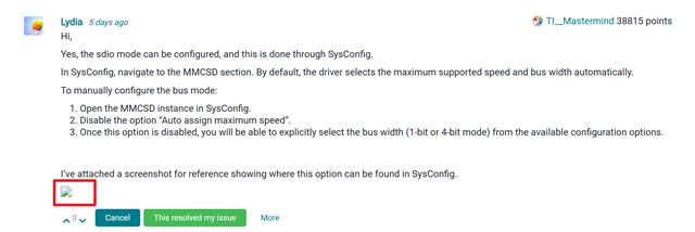

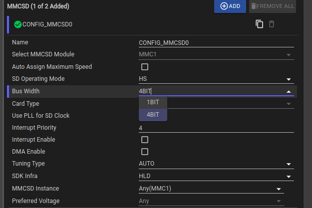

  • Hi,

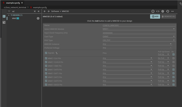

    Yes, the sdio mode can be configured, and this is done through SysConfig.
    In SysConfig, navigate to the MMCSD section. By default, the driver selects the maximum supported speed and bus width automatically.
    To manually configure the bus mode:
    1. Open the MMCSD instance in SysConfig.
    2. Disable the option “Auto assign maximum speed”.
    3. Once this option is disabled, you will be able to explicitly select the bus width (1-bit or 4-bit mode) from the available configuration options.
    I’ve attached a screenshot for reference showing where this option can be found in SysConfig.

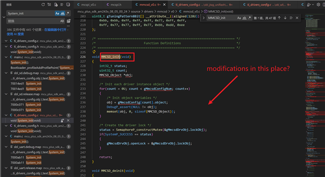

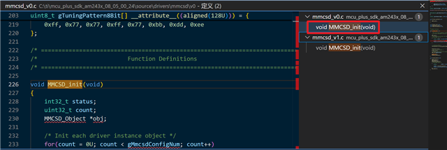

    However, SDIO is not currently supported in the MCU+SDK. If the customer wants to achieve SDIO functionality, they will need to modify the MMCSD driver according to the SDIO protocol.
  • Thank you. But this picture cannot be loaded and cannot be seen. Can you resend it?
  • Thank you. Can you provide an example of the SDIO interface driver on the development board I am using? Or SDIO drivers on similar development boards, I don't know how to implement the driver for this SDIO interface.
