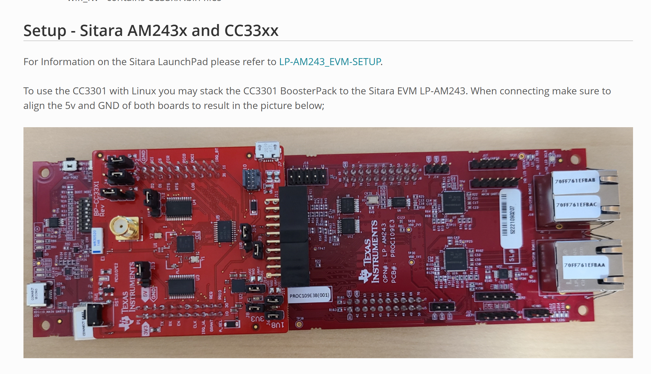

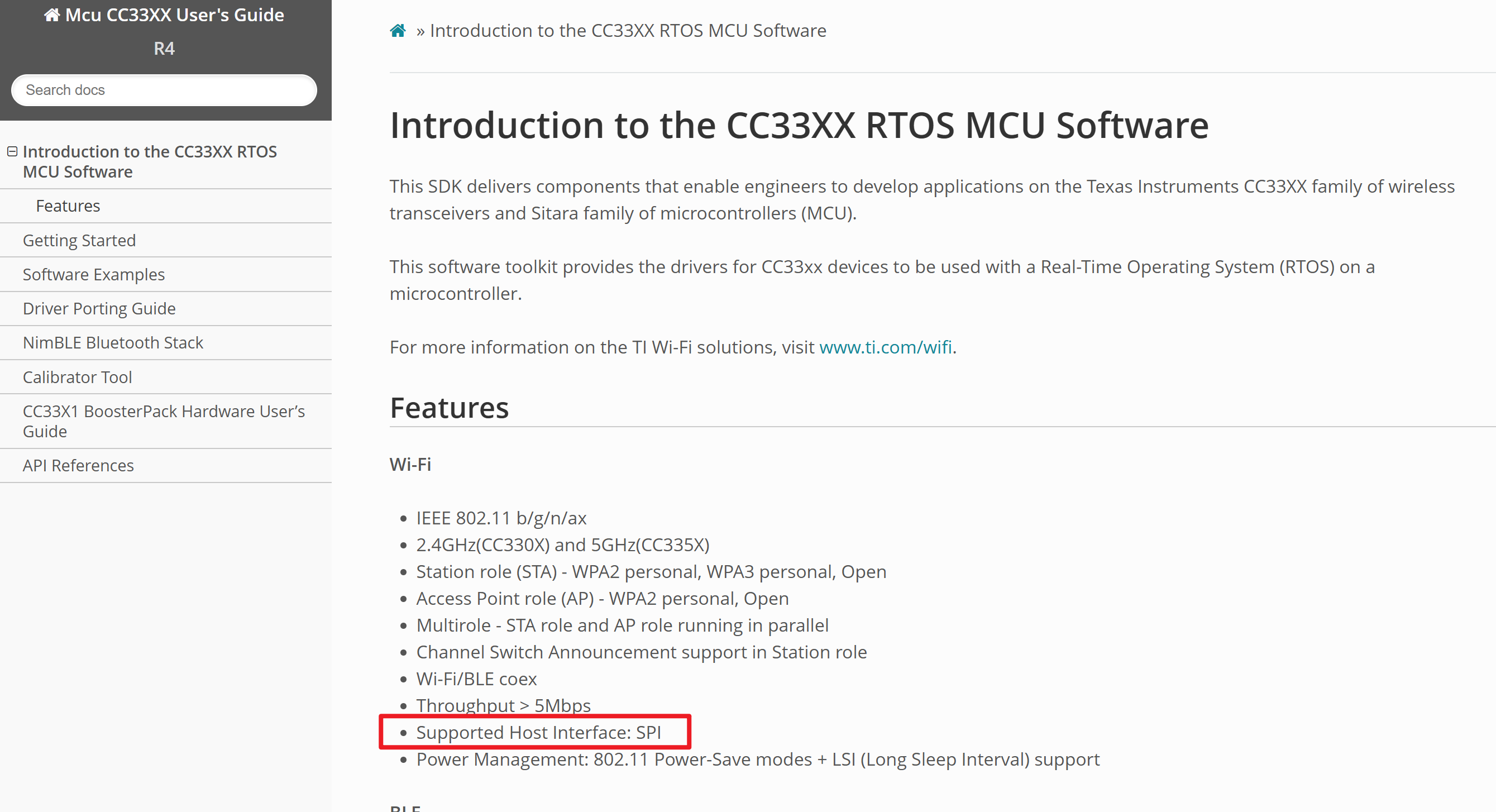

Does the LP-AM243 and CC3351 support the sdio interface in the RTOS system and can you provide an example of the code implementation of the sdio interface.I only found support for the SPI interface in the user guidance document, not for the SDIO interface.

    We currently do not have a code example for using the SDIO interface; in the picture you presented, the AM243 and CC33xx are connected in that manner to easily support the SPI interface as mentioned in the other thread I referenced.

    Like I previously mentioned, we do not have an example using the SDIO interface. We will not be providing SDIO implementation unless it is a feature that is absolutely necessary for your customer, and if there is strong reason from your customer that SPI cannot be used between these two devices.
    If you look at the launchpads of the AM243 and the BP3351 and examine the pinouts, here is additional headwind for your customer: the pins do not line up! The customer will have to use jumper wires just to set up the right connections for the SDIO interface, and the customer also needs to verify the supported voltage levels for the SDIO pins.
    Therefore, we strongly recommend using SPI to avoid all this headache.

    Our previous recommendation for the customer would be to implement the SDIO interface themselves (something many customers have successfully done with their own hosts) for the AM243x while using jumper wires to connect the proper pins between the AM243x and BP CC33x1 and being aware of the supported voltage levels for the SDIO pins.
    Another option (which we strongly recommend) would be for your customer to simply switch the product design to SPI, which is much easier integrate and set up between the AM243x and BP CC33x1. We also have guides for this to walk your customer through the process.
    If your customer's only option is to use SDIO but is willing to use a different host to talk to the BP CC33x1, we highly recommend your customer to use a Linux MPU host.
