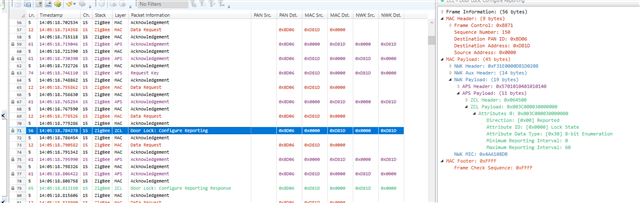

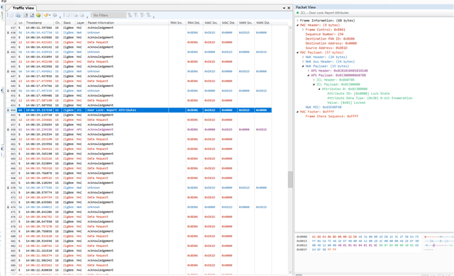

I am currently working on a Zigbee door lock project using the CC2340R5, where the Zigbee module acts as a node, and the gateway is provided by the customer. In the .syscfg file, I have set the poll period to 3000 ms. After successfully joining the network through the gateway, I used packet capture (sniffer) to observe that the Data Request frames were initially sent every 3 seconds. However, after some time, the device started sending Data Request frames more frequently — multiple times within 3 seconds, which causes the current consumption to increase.
In contrast, when I use my own configured CC2652 coordinator, the Data Request frames are sent evenly every 3 seconds.
I would like to know whether this issue is related to the coordinator, and how can I prove whether it's caused by the coordinator or not?

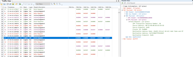

The attachments are the packages caught by me using 2652 as the coordinator and by the client's coordinator respectively

Did the customer follow step 6. from: Zigbee Fundamental Project Development?
"Once the bind is successfully confirmed using bind_device_cb, we can use ZB_ZCL_GENERAL APIs to configure reporting on the light. LIGHT_REPORTING_MIN_INTERVAL represents the minimum time delay before the on/off attribute is reported, whereas LIGHT_REPORTING_MAX_INTERVAL is the maximum allowed time."
Can you check that the following two lines of code are present and used?
