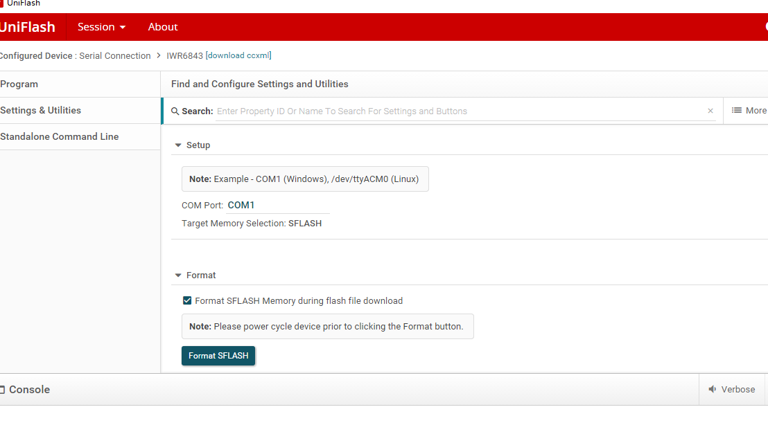

在新的电脑上使用这个板子,但是在设备管理器中显示其他设备,如下图所示:
请问需要安装什么?

  • I try the method
    the first it need to fill the com port number,such as the figure
    for the second method, it also need to fill the com port
    for the third method ,I have ccs v8 and ccs10.
    I think the pc con't show the port of  the device, is becose the pc don't have a right driver. however I install the lasted ccs,mmwave_studio, sdk, I con't know what should i do . what's more the device can get the com port of the 1443boost
