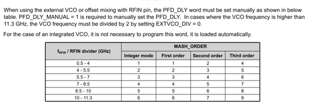

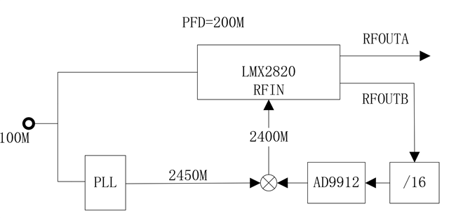

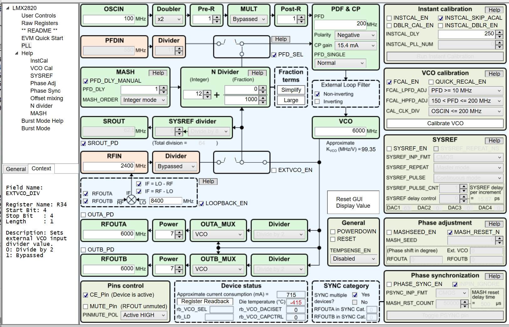

the above is my schematic diagram,i use loopback mode,and the registers configuration is as following,but i can't lock,how to configure the register

mem[5] <= 24'h250300 ; //R37 PFD_DLY

mem[7] <= 24'h233000 ; //R35 [8:7] MASH_ORDER 0=Integer mode
mem[8] <= 24'h220810 ; //R34 LOOPBACK_EN=1 EXTVCO_DIV=1
mem[9] <= 24'h171103 ; //R23 [0] VCO_SEL_FORCE 0x0 = Disable 0x1 = Enabled Forces the VCO to use the core specified by VCO_SEL Useful for full-assisted VCO calibration and debugging purposes.
mem[10] <= 24'h1622BF ; //R22 [15:13]VCO_SEL [7:0]VCO_CAPCTRL VCO1 5.65~6.35G VCO2 6.35~7.3G VCO3 7.3~8.1G

mem[13] <= 24'h10171E ; //R16 [4:1] CPG
mem[14] <= 24'h0F2001 ; //R15 [11] PFD_POL [10:9]PFD_SINGLE 0x0 = Normal operation 0x3 = Single PFD
mem[15] <= 24'h0D0038 ; //R13 [12:5]PLL_R Sets reference path Post-R divider value.
mem[16] <= 24'h0B0612 ; //R11 [4] OSC_2X 0 = Disabled 1=enable
mem[17] <= 24'h0A1000 ; //R10 [12]PFD_DLY_MANUAL
