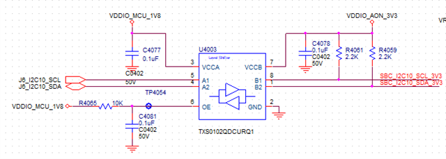

目前我的TXS0102设计如下,OE是通过10K电阻上拉到VCCA的电源

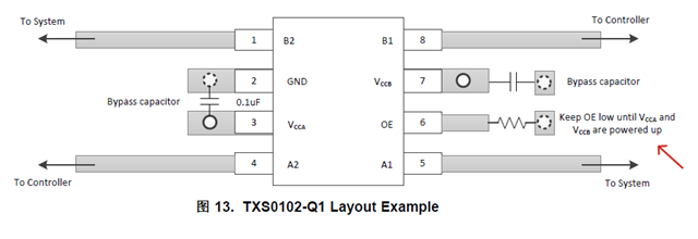

但是手册有描述要求在VCCA和VCCB上电前,OE需要保持低电平。
麻烦问下
1、我现在这样设计是否会有问题
2、在VCCA和VCCB上电完成前,为什么OE需要保持低电平

    关于你的咨询,你这样设计,OE是通过10K电阻上拉到VCCA的电源是没问题的。
    1和2问,你可以看看下面的说明。
    The datasheet says:ensure the high-impedance state during power up or power down, OE should be tied to GND through a pulldown resistor.
    If you do not care about the state of the I/O pins during power up/down, you can connect it to VCC.
    external pullups at the I/Os can also be removed as the device has internal 10kohm pullups already. Current implementation will lead to higher VOL levels.
