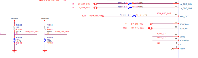

    Below are my comments:
    1. It looks like the devices are set to I2C mode. Why is the customer having pulldowns on SDA/SCL?
    2. Based on the DDC connections, it looks like DDC buffer is disabled. However, the customer has HV_DDC connected. Was this for DDC snooping feature? If so, they have to connect to LV_DDC not HV_DDC since snooping is on LV_DDC side.

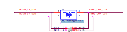

    6.
    Please ensure CMC gives differential impedance of 100 ohm:

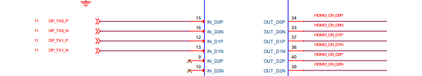

    7. U93 is missing data connections:
    [Eddie] Sorry, I have deleted the pull down resistors. Please kindly refer to the lastest SCH.
    [Eddie] I have updated the SCH, please kindly refer to the lastest SCH.
    6.
    [Eddie] Is it ok if I pick 90ohm CMC as default ?
    [Eddie] Thanks for the reminding. Please kindly refer to the lastest SCH.
  • [Eddie] Is it ok if I pick 90ohm CMC as default ?
    I checked on my end, and this should be fine.
    Below are my comments on the updated schematic:
    1. For U8, I see that it has both level shifter and TDP0604 DDC connections:
    If using level shifter, please disconnect on HV_DDC side. If using DDC snoop feature, please disconnect HV_DDC side and then connect LV_DDC side.

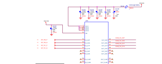

    2. Is U13 taking DP++ signal? I noticed that it has decoupling capacitors on the RX side of the redriver.
    3. U93 is still missing some connections:
    [Eddie] Sorry, I have updated the sch again. Please see revised verison.
    [Eddie] U93 is appled for DP to HDMI ; U8 is applied for HDMI IN ; U13 is applied for HDMI OUT.

  • Hi,
    U93 is still missing a connection.
    Does U93 take DP signal, or DP++? Could you please confirm? Our part is not an active redriver so we will not be able to make DP signal into HDMI unless the input signal is DP++.
    [Eddie] The host output standard DP signal. If TDP0604 can not support DP , may I have your comments for other suitable part ?

  • U93 is still missing a connection.
    [Eddie] Sorry, do you mean the HPD_OUT ?
    U93 is missing Lane 2 data input connection.
    Unfortunately, TI does not have an active protocol converter from DP to HDMI. However, we support DP++ signal from the source so please check again if the source outputs DP++. In addition, TDP0604 can be used in DP mode and output DP signal instead if you consider using a DP connector.
