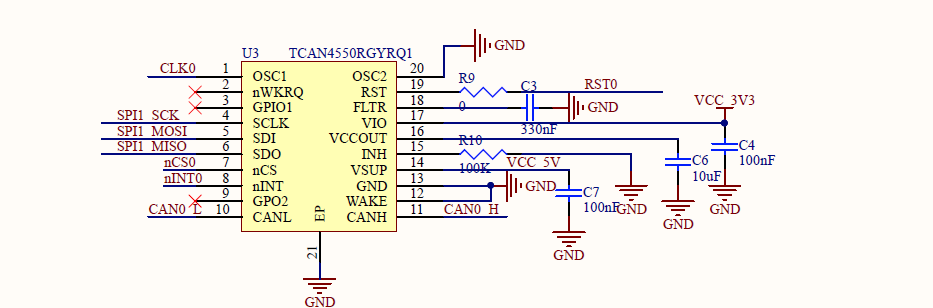

我们使用的是NVIDIA Jetson Thor平台,通过SPI拓展CAN,具体电路如下:
VSUP已经链接到了12V,并将R9电阻取消焊接,

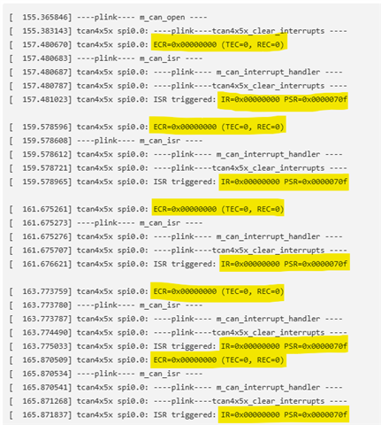

当通过IP link打开can总线之后,dmesg日志会一直输出下述内容:
[  155.365846] ----plink---- m_can_open ----
[  155.383143] tcan4x5x spi0.0: ----plink----tcan4x5x_clear_interrupts ----
[  157.480670] tcan4x5x spi0.0: ECR=0x00000000 (TEC=0, REC=0)
[  157.480683] ----plink---- m_can_isr ----
[  157.480687] tcan4x5x spi0.0: ----plink---- m_can_interrupt_handler ----
[  157.480787] tcan4x5x spi0.0: ----plink----tcan4x5x_clear_interrupts ----
[  157.481023] tcan4x5x spi0.0: ISR triggered: IR=0x00000000 PSR=0x0000070f
[  159.578596] tcan4x5x spi0.0: ECR=0x00000000 (TEC=0, REC=0)
[  159.578608] ----plink---- m_can_isr ----
[  159.578612] tcan4x5x spi0.0: ----plink---- m_can_interrupt_handler ----
[  159.578721] tcan4x5x spi0.0: ----plink----tcan4x5x_clear_interrupts ----
[  159.578965] tcan4x5x spi0.0: ISR triggered: IR=0x00000000 PSR=0x0000070f
[  161.675261] tcan4x5x spi0.0: ECR=0x00000000 (TEC=0, REC=0)
[  161.675273] ----plink---- m_can_isr ----
[  161.675276] tcan4x5x spi0.0: ----plink---- m_can_interrupt_handler ----
[  161.675707] tcan4x5x spi0.0: ----plink----tcan4x5x_clear_interrupts ----
[  161.676621] tcan4x5x spi0.0: ISR triggered: IR=0x00000000 PSR=0x0000070f
[  163.773759] tcan4x5x spi0.0: ECR=0x00000000 (TEC=0, REC=0)
[  163.773780] ----plink---- m_can_isr ----
[  163.773787] tcan4x5x spi0.0: ----plink---- m_can_interrupt_handler ----
[  163.774490] tcan4x5x spi0.0: ----plink----tcan4x5x_clear_interrupts ----
[  163.775033] tcan4x5x spi0.0: ISR triggered: IR=0x00000000 PSR=0x0000070f
[  165.870509] tcan4x5x spi0.0: ECR=0x00000000 (TEC=0, REC=0)
[  165.870534] ----plink---- m_can_isr ----
[  165.870541] tcan4x5x spi0.0: ----plink---- m_can_interrupt_handler ----
[  165.871268] tcan4x5x spi0.0: ----plink----tcan4x5x_clear_interrupts ----
[  165.871837] tcan4x5x spi0.0: ISR triggered: IR=0x00000000 PSR=0x0000070f

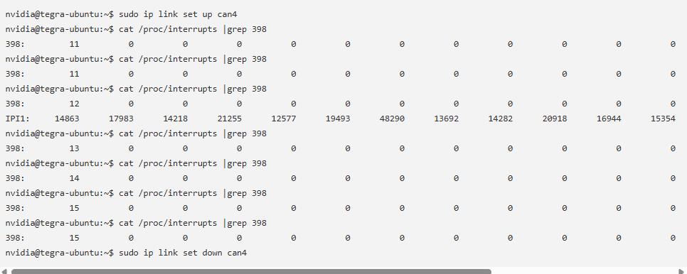

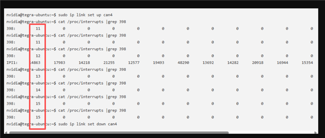

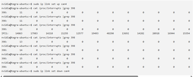

同时中断计数会一直增加,直到关闭CAN总线
现象如下:
nvidia@tegra-ubuntu:~$ sudo ip link set up can4
nvidia@tegra-ubuntu:~$ cat /proc/interrupts |grep 398
398:         11          0          0          0          0          0          0          0          0          0          0          0          0          0 cf00000.gpio  22 Level     can4
398:         12          0          0          0          0          0          0          0          0          0          0          0          0          0 cf00000.gpio  22 Level     can4
IPI1:     14863      17983      14218      21255      12577      19493      48290      13692      14282      20918      16944      15354      53524      23989       Function call interrupts
398:         13          0          0          0          0          0          0          0          0          0          0          0          0          0 cf00000.gpio  22 Level     can4
398:         14          0          0          0          0          0          0          0          0          0          0          0          0          0 cf00000.gpio  22 Level     can4
398:         15          0          0          0          0          0          0          0          0          0          0          0          0          0 cf00000.gpio  22 Level     can4
nvidia@tegra-ubuntu:~$ sudo ip link set down can4

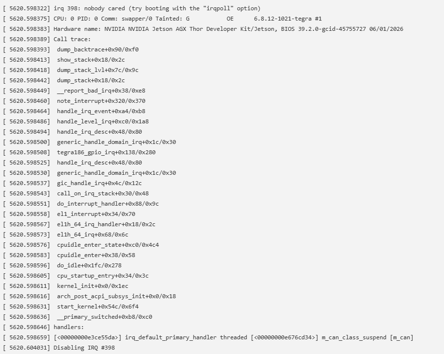

这个情况会持续到系统自动禁用该中断,并且系统日志输出如下内容:
[ 5620.598322] irq 398: nobody cared (try booting with the "irqpoll" option)
[ 5620.598375] CPU: 0 PID: 0 Comm: swapper/0 Tainted: G           OE      6.8.12-1021-tegra #1
[ 5620.598383] Hardware name: NVIDIA NVIDIA Jetson AGX Thor Developer Kit/Jetson, BIOS 39.2.0-gcid-45755727 06/01/2026
[ 5620.598389] Call trace:
[ 5620.598393]  dump_backtrace+0x90/0xf0
[ 5620.598413]  show_stack+0x18/0x2c
[ 5620.598418]  dump_stack_lvl+0x7c/0x9c
[ 5620.598442]  dump_stack+0x18/0x2c
[ 5620.598449]  __report_bad_irq+0x38/0xe8
[ 5620.598460]  note_interrupt+0x320/0x370
[ 5620.598464]  handle_irq_event+0xa4/0xb8
[ 5620.598486]  handle_level_irq+0xc0/0x1a8
[ 5620.598494]  handle_irq_desc+0x48/0x80
[ 5620.598500]  generic_handle_domain_irq+0x1c/0x30
[ 5620.598508]  tegra186_gpio_irq+0x138/0x280
[ 5620.598525]  handle_irq_desc+0x48/0x80
[ 5620.598530]  generic_handle_domain_irq+0x1c/0x30
[ 5620.598537]  gic_handle_irq+0x4c/0x12c
[ 5620.598543]  call_on_irq_stack+0x30/0x48
[ 5620.598551]  do_interrupt_handler+0x88/0x9c
[ 5620.598558]  el1_interrupt+0x34/0x70
[ 5620.598567]  el1h_64_irq_handler+0x18/0x2c
[ 5620.598573]  el1h_64_irq+0x68/0x6c
[ 5620.598576]  cpuidle_enter_state+0xc0/0x4c4
[ 5620.598583]  cpuidle_enter+0x38/0x58
[ 5620.598596]  do_idle+0x1fc/0x278
[ 5620.598605]  cpu_startup_entry+0x34/0x3c
[ 5620.598611]  kernel_init+0x0/0x1ec
[ 5620.598616]  arch_post_acpi_subsys_init+0x0/0x18
[ 5620.598631]  start_kernel+0x54c/0x6f4
[ 5620.598636]  __primary_switched+0xb8/0xc0
[ 5620.598646] handlers:
[ 5620.598659] [<00000000e3ce55da>] irq_default_primary_handler threaded [<00000000e676cd34>] m_can_class_suspend [m_can]
[ 5620.604031] Disabling IRQ #398

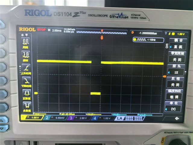

  • 当总线UP之后,我通过示波器查看到,终端引脚在中断计数增加的时候,周期性的被拉低

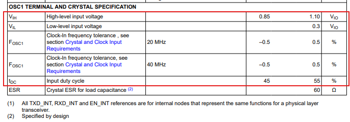

  • 有关于TCAN4550器件时钟要求的详细说明嘛?当前的情况CAN总线能正常收发,但是在空闲状态频繁的触发中断,这不符合实际的应用。
    另外,TCAN4550的驱动程序,我是直接从内核中获取的源码进行编译的。从源码中的信息来看,驱动程序是你们提供的Dan Murphy <dmurphy@ti.com>
    能否申请一位同时了解Linux系统的支持呢?目前这个问题已经困惑我们很久了。希望得到你们的帮组
  • 请问您有TCAN4550器件时钟要求的详细说明吗?目前,CAN总线可以正常收发数据,但在空闲状态下频繁触发中断,这不适用于实际应用。
    您能告诉我空闲状态下具体生成了哪些中断位吗?如果可以,我可以帮助您理解这些位被置位的原因,并帮助您确定如何阻止它们被置位。请告诉我寄存器 0x​​000C、0x0820 和 0x0824 的值,以便我查看哪些状态位和中断位被置位。

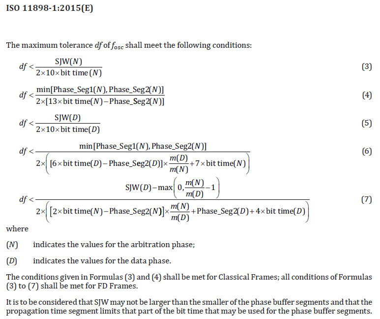

    我们有几份应用报告讨论了时钟电路的优化要求,尤其是在使用晶振时。使用单端时钟通常不是问题,时钟信号只需是符合数据手册要求的单端信号即可。
    TCAN455x 时钟优化和设计指南应用报告链接
    TCAN455x-Q1 外围电路和时钟设计应用报告链接

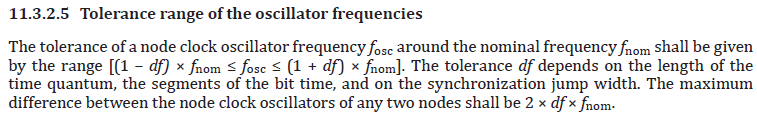

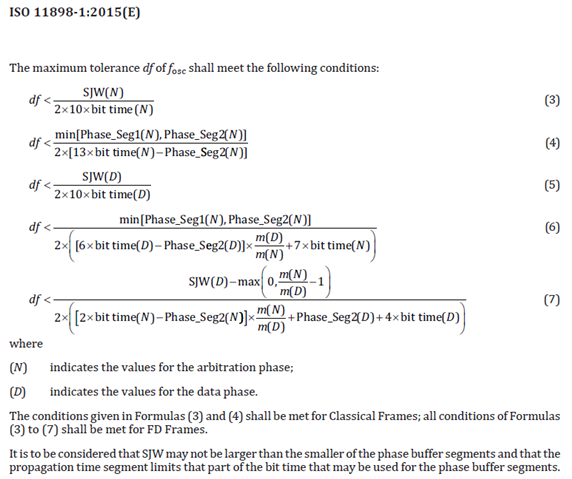

    如果您的问题更侧重于 CAN 通信的时钟要求,那么 ISO 11898-1 标准以及许多其他文档中都列出了一些要求,这些文档讨论了如何分配时间量子以获得良好的采样点。TCAN4550-Q1 使用了博世开发的 MCAN IP,有一篇应用笔记详细讨论了 CAN FD 位定时配置,您可能对此感兴趣。
    CAN FD链路)的比特时间要求
    ISO 11898-1 时钟振荡器容差规范要求如下:

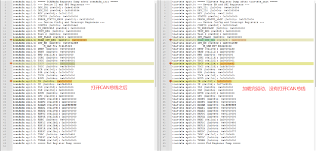

  • 我无法在论坛上直接恢复消息了,只能以邮件的方式发送给你,同时在之前的消息上进一步进行回复。
    其实我们现在不确定具体是驱动的问题,还是由于硬件电路上时钟的问题,所以需要你们的协助。
    关于芯片的寄存器值如下,我导出了所有的寄存器的值

    下图的日志中只需要关注我红框出来的一列,该数字表示中断触发的次数,正常情况下,只是将CAN总线打开,不进行数据的收发操作,中断次数不应该出现递增的情况。
    实际上无论是标准CAN还是CANFD都会出现这个问题,
    另外如果忽略这个问题直接进行收发测试的话,CAN或者CANFD都是正常的,只不过频繁增加的中断计数,会直接导致系统禁用掉该中断。从而导致CAN总线无法再进行数据的收发。

  • 很抱歉没有及时的回复,之前手上有其他的事情耽搁了,
    按照您的提示,我将TSW位设置为0之后,还是会频繁的产生中断,
    我对比了一下打开CAN设备前后导出的寄存器的值,发现下列三个寄存器的值有明显的变化,
  • 时间已经过去很久了,请问还有其他的建议嘛?目前来看,将TSWE位设置为0之后,终端还是会持续增加。
  • 在您之前提供的寄存器值中,只有 TSW 中断位被置位。如果您已将其屏蔽,使其无法在 nINT 引脚上触发硬件中断,那么可能存在其他中断位导致了中断。请提供更新后的寄存器值。
    问候,
    乔纳森
  • 在前一条帖子中,我已经提供了更新后的寄存器值,并对屏蔽TSW终端为之后,打开CAN总线前后的寄存器信息做了对比。
  • 请再次提供该信息,因为它似乎没有出现在这个帖子中。我没有看到您之前包含该信息的帖子。您刚刚发布的图片分辨率太低,我无法辨认数值。
    请您再次提供这些信息好吗?

  • 加载驱动之后的寄存器信息:
    [ 41.116523] tcan4x5x spi0.0: ----plink---- tcan4x5x_init ----
    [ 41.116525] tcan4x5x spi0.0: ----plink----tcan4x5x_clear_interrupts ----
    [ 41.116800] tcan4x5x spi0.0: ===== TCAN4x5x Register Dump after tcan4x5x_init =====
    [ 41.116803] tcan4x5x spi0.0: --- Device ID and SPI Registers ---
    [ 41.116854] tcan4x5x spi0.0: DEV_ID1 (0x0000): 0x4e414354
    [ 41.116920] tcan4x5x spi0.0: DEV_ID2 (0x0004): 0x30353534
    [ 41.116971] tcan4x5x spi0.0: REV (0x0008): 0x00110201
    [ 41.117024] tcan4x5x spi0.0: STATUS (0x000c): 0x00000008
    [ 41.117075] tcan4x5x spi0.0: ERROR_STATUS_MASK (0x0010): 0x3f3f0000
    [ 41.117078] tcan4x5x spi0.0: --- Device Config and Interrupt Registers ---
    [ 41.117129] tcan4x5x spi0.0: CONFIG (0x0800): 0x080004a8
    [ 41.117181] tcan4x5x spi0.0: TS_PRESCALE (0x0804): 0x00000002
    [ 41.117244] tcan4x5x spi0.0: TEST_REG (0x0808): 0x00000000

  • 我不知道MCU是否在你创建日志文件之前清除了中断位,但MCAN中断寄存器0x1050中唯一被置位的中断位是第29位,即访问保留地址(ARA)位。当你从保留寄存器空间执行SPI读取操作时,该位会被置位。
    我不知道这是在读取寄存器创建日志时产生的,还是在运行时产生的。
    中断引脚 nINT 是寄存器 0x​​0820 和 0x0824 中所有已置位的使能位的逻辑或结果。非 CAN 设备类型的中断反映在寄存器 0x​​0800 中,而 CAN 相关中断反映在寄存器 0x​​1050 中。请注意,寄存器 0x​​0824 只是寄存器 0x​​1050 的只读副本,这样当长度字段设置为 2 时,就可以在单个 SPI 事务中读取两组中断位。
    由于寄存器 0x​​1054 中的寄存器位 29 未被设置为 0,因此 ARA 位尚未启用以引发硬件中断。这就是为什么即使 ARA 位已设置,寄存器 0x​​0820 的 M_CAN_INT 位(位 1)也未被设置的原因。
    遗憾的是,日志中没有显示 nINT 引脚产生中断的任何原因。
