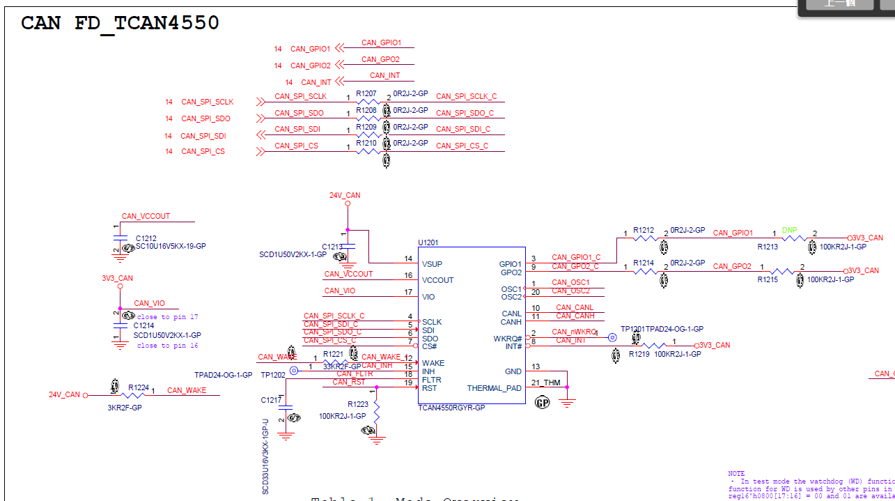

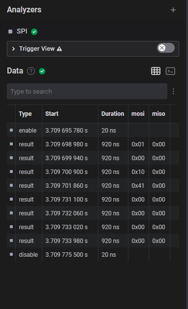

We are integrating the TCAN4550 into our system.
Initialize the SPI directly after powered on, and then perform the read operation.
The SPI communications is working. But SDO can't receive any data like below chart:

  • 您好,
    请注意 TCAN4550在SCLK的上升沿采集SDI数据,在SCLK的下降沿输出数据至SDO管脚。因此建议您先检查下是否在SCLK的上升沿输入SDI 的数据已保持稳定,主控端应在SCLK的上升沿读取SDO输出数据。
