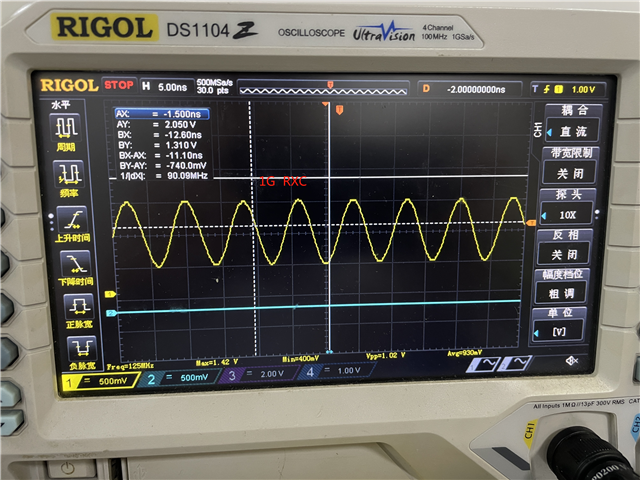

The PS side of the Xilinx board connects the DP83867IR through RGMII mode, runs the self-negotiation program through the SDK (the program includes the PHY register writing), and the program shows that the MAC address is successfully assigned. But the current phenomenon is that the host computer can't identify the network and can't ping the MAC address. The following is the self-negotiated register state.

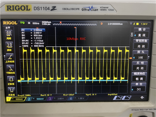

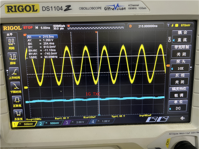

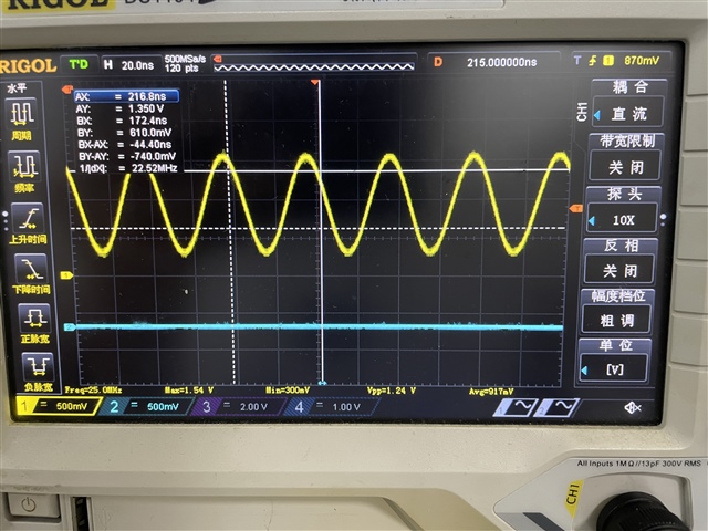

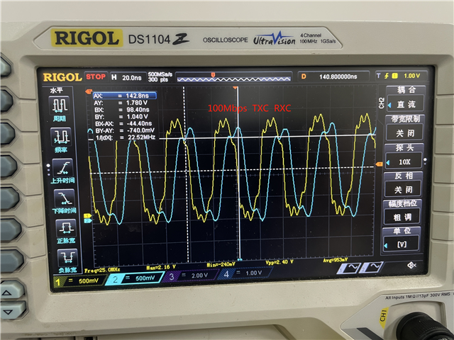

  • In the case of self-negotiation to 1000Mbps, the following figure shows the waveforms of RXC and TXC at the normal frequency of 125Mhz. But it's not a square wave. The 100Mbps case is also a 25Mhz sine wave. Only 10MBPS would be a 2.5MHZ square wave. The captured RXD3 waveform shows that there is data passing through and the data is only square wave if it is 10MBPS. But even 10MBPS won't work. TXD has no data at all.
  • At 10Mbps, this is the timing diagram for RXC and RXD3. About 2.5 to 3ns before the rising edge comes.

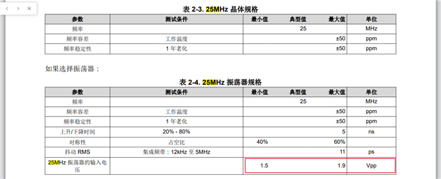

  • After measuring, I found that the pendulum swing of XI's external crystal input is about 1.22VPP, and the oscillator given by the official needs 1.5-1.9VPP. If it is crystal input, is 1.2VPP also working normally?
