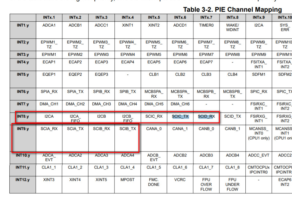

dsp28388D在sci_ex2_loopback_interrupts例程中,为什么SCIA和SCIB可用,配置SCIC和SCID没反应
  • 能否给出您的相关代码?您的SCIC和SCID的硬件引脚是如何设置的?
  • 用的官方的28388开发板测试,而且是loopback'模式跟管脚没关系
  • 您是否有修改  Interrupt_clearACKGroup(INTERRUPT_ACK_GROUP9);
    为
    Interrupt_clearACKGroup(INTERRUPT_ACK_GROUP8);
    另外附上我的测试程序,可以成功的

        // GPIO28 is the SCI Rx pin.
        GPIO_setMasterCore(39, GPIO_CORE_CPU1);
        GPIO_setPinConfig(GPIO_39_SCIC_RX);
        GPIO_setDirectionMode(39, GPIO_DIR_MODE_IN);
        GPIO_setPadConfig(39, GPIO_PIN_TYPE_STD);
        GPIO_setQualificationMode(39, GPIO_QUAL_ASYNC);
        // GPIO29 is the SCI Tx pin.
        GPIO_setMasterCore(38, GPIO_CORE_CPU1);
        GPIO_setPinConfig(GPIO_38_SCIC_TX);
        GPIO_setDirectionMode(38, GPIO_DIR_MODE_OUT);
        GPIO_setPadConfig(38, GPIO_PIN_TYPE_STD);
        GPIO_setQualificationMode(38, GPIO_QUAL_ASYNC);
        // Initialize PIE and clear PIE registers. Disables CPU interrupts.
        Interrupt_initModule();
        // Initialize the PIE vector table with pointers to the shell Interrupt
        // Service Routines (ISR).
        Interrupt_initVectorTable();
        // Interrupts that are used in this example are re-mapped to
        // ISR functions found within this file.
        Interrupt_register(INT_SCIC_RX, scicRXFIFOISR);
        Interrupt_register(INT_SCIC_TX, scicTXFIFOISR);
        // Initialize the Device Peripherals:
        initSCICFIFO();
        // Init the send data.  After each transmission this data
        // will be updated for the next transmission
        for(i = 0; i < 2; i++)
            sDataA[i] = i;
        rDataPointA = sDataA[0];
        Interrupt_enable(INT_SCIC_RX);
        Interrupt_enable(INT_SCIC_TX);

    __interrupt void scicTXFIFOISR(void)
        uint16_t i;
        SCI_writeCharArray(SCIC_BASE, sDataA, 2);
        // Increment send data for next cycle
            sDataA[i] = (sDataA[i] + 1) & 0x00FF;
        SCI_clearInterruptStatus(SCIC_BASE, SCI_INT_TXFF);
        // Issue PIE ACK
    // sciaRXFIFOISR - SCIA Receive FIFO ISR
    __interrupt void scicRXFIFOISR(void)
        uint16_t i;
        SCI_readCharArray(SCIC_BASE, rDataA, 2);
        // Check received data
            if(rDataA[i] != ((rDataPointA + i) & 0x00FF))
                error();
        rDataPointA = (rDataPointA + 1) & 0x00FF;
        SCI_clearOverflowStatus(SCIC_BASE);
        SCI_clearInterruptStatus(SCIC_BASE, SCI_INT_RXFF);
        // Issue PIE ack
