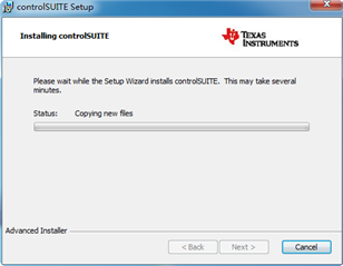

试一下CONTROLSUITE:
C:\ti\controlSUITE\device_support\f2803x\v130
C:\ti\controlSUITE\libs\math\CLAmath\v300
