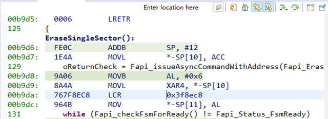

开发二次Bootloader功能,程序在擦除Flash的时候可能会出现崩溃的情况。
项目的cmd文件如下:

操作flash的关键代码如下:
//before using any FlashAPI ,Initalize it first void Upgrade_Initialize_FlashAPI() { if(isFlashAPI_Initialized) return; Fapi_StatusType oReturnCheck; oReturnCheck = Fapi_initializeAPI(F021_CPU0_BASE_ADDRESS, DEVICE_SYSCLK_FREQ/1000000U); if(oReturnCheck != Fapi_Status_Success) return; oReturnCheck = Fapi_setActiveFlashBank(Fapi_FlashBank0); if(oReturnCheck != Fapi_Status_Success) return; isFlashAPI_Initialized = true; } //Erase single sector at address #pragma CODE_SECTION(EraseSingleSector, ".TI.ramfunc"); Fapi_StatusType EraseSingleSector(Uint32 u32StartAddress) { Fapi_StatusType oReturnCheck; Fapi_FlashStatusWordType oFlashStatusWord; oReturnCheck = Fapi_issueAsyncCommandWithAddress(Fapi_EraseSector,(Uint32 *)u32StartAddress); //wait uintil FSM is done with erase sector operation while (Fapi_checkFsmForReady() != Fapi_Status_FsmReady) { ServiceDog(); } if(oReturnCheck != Fapi_Status_Success) return oReturnCheck; //verify the sector is erased oReturnCheck = Fapi_doBlankCheck((Uint32 *)u32StartAddress,Sector8KB_u32length,&oFlashStatusWord); return oReturnCheck; } //Program flash ,must reside in RAM #pragma CODE_SECTION(Upgrade_ProgramFlash, ".TI.ramfunc"); Fapi_StatusType Upgrade_ProgramFlash(Uint32 u32StartAddress,uint16 *pu16DataBuffer,uint16 u16DataBufferSizeinWords) { Fapi_StatusType oReturnCheck; //Disable intterupt before programming DINT; oReturnCheck = Fapi_issueProgrammingCommand((Uint32*)u32StartAddress,pu16DataBuffer,u16DataBufferSizeinWords,0,0,Fapi_AutoEccGeneration); //wait uintil FSM is done with erase sector operation while (Fapi_checkFsmForReady() != Fapi_Status_FsmReady) { ServiceDog(); } // Fapi_getFsmStatus(); //Enable intterupt after programming EINT; return oReturnCheck; } //Erase sectors of boot bool Upgrade_EraseSectorOfBoot() { Upgrade_Initialize_FlashAPI(); if(Fapi_Status_Success != EraseSingleSector(Bzero_Sector0_start)) return false; if(Fapi_Status_Success != EraseSingleSector(Bzero_Sector1_start)) return false; u16UpgradeFlag = Upgrade_Flag_Boot; u32ProgramStartAddress = Boot_StartAddress; u32ProgramEndAddress = Boot_EndAddress; u32ProgrammingAddress = Boot_StartAddress; return true; } //Erase sectors of App1 bool Upgrade_EraseSectorOfApp1() { DINT; Upgrade_Initialize_FlashAPI(); if(Fapi_Status_Success != EraseSingleSector((Uint32)Bzero_Sector2_start)) return false; if(Fapi_Status_Success != EraseSingleSector((Uint32)Bzero_Sector3_start)) return false; if(Fapi_Status_Success != EraseSingleSector((Uint32)Bzero_Sector4_start)) return false; if(Fapi_Status_Success != EraseSingleSector((Uint32)Bzero_Sector5_start)) return false; if(Fapi_Status_Success != EraseSingleSector((Uint32)Bzero_Sector6_start)) return false; if(Fapi_Status_Success != EraseSingleSector((Uint32)Bzero_Sector7_start)) return false; if(Fapi_Status_Success != EraseSingleSector((Uint32)Bzero_Sector8_start)) return false; u16UpgradeFlag = Upgrade_Flag_App1; u32ProgramStartAddress = App1_StartAddress; u32ProgramEndAddress = App1_EndAddress; u32ProgrammingAddress = App1_StartAddress; EINT; return true; } //Erase sectors of App2 bool Upgrade_EraseSectorOfApp2() { DINT; Upgrade_Initialize_FlashAPI(); if(Fapi_Status_Success != EraseSingleSector((Uint32)Bzero_Sector9_start)) return false; if(Fapi_Status_Success != EraseSingleSector((Uint32)Bzero_Sector10_start)) return false; if(Fapi_Status_Success != EraseSingleSector((Uint32)Bzero_Sector11_start)) return false; if(Fapi_Status_Success != EraseSingleSector((Uint32)Bzero_Sector12_start)) return false; if(Fapi_Status_Success != EraseSingleSector((Uint32)Bzero_Sector13_start)) return false; if(Fapi_Status_Success != EraseSingleSector((Uint32)Bzero_Sector14_start)) return false; if(Fapi_Status_Success != EraseSingleSector((Uint32)Bzero_Sector15_start)) return false; u16UpgradeFlag = Upgrade_Flag_App2; u32ProgramStartAddress = App2_StartAddress; u32ProgramEndAddress = App2_EndAddress; u32ProgrammingAddress = App2_StartAddress; EINT; return true; } //if App2 has valid app code,erase app1 sectors,copy app2 data to app1 data void Upgrade_CheckUpgrade() { Uint32 u32Address_Read; Uint32 u32Address_Write; if(IsApp2_Valid()) { //clear app1 data code Upgrade_EraseSectorOfApp1(); //copy app2 to app1 u32Address_Read = App2_StartAddress; u32Address_Write = App1_StartAddress; while(u32Address_Read < App2_EndAddress) { Upgrade_ProgramFlash(u32Address_Write,(Uint16 *)u32Address_Read,8); u32Address_Read += 8; u32Address_Write += 8; } //clear app2 data code Upgrade_EraseSectorOfApp2(); } }
调用 Upgrade_EraseSectorOfApp2()函数,擦除Sector9后,在擦除sector10时程序进入ESTOP0
程序跟踪可以看到,调用的Fapi_issueAsynCommand 函数位于 0x3f8ec8
请问擦除后崩溃的原因可能是什么?
