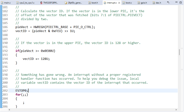

I debugged and found it reports the PIE Vector Error:
So I debugged as follows:
  1. Use "DINT;" disable all the interrupt before jumping to the app.
  2. Disable all the interrupts in boot. Do not initial any interrupt at the firmware.
However, this error doesn't resolved.

  • If I mask these two lines, the whole boot didn't report this error anymore.

    So, what command should be used to jump from boot to app in TMS320F28P650DH?
  • I apologize for the delay. I am going to loop in the bootloader expert to see if they have any input on this. That ESTOP is usually hit when an interrupt that has been enabled in the ePIE but doesn't have an associated ISR is triggered. Are you enabling/using any interrupts in your bootloader? Even though you are calling DINT, it could be that an interrupt from before that is already being propagated through.
