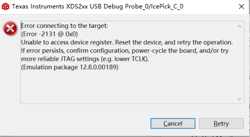

TMS320F28P650DK: DCSM加密后仿真器无法连接
Part Number: TMS320F28P650DK

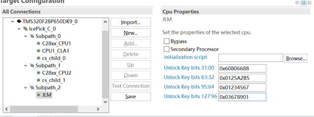

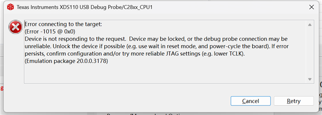

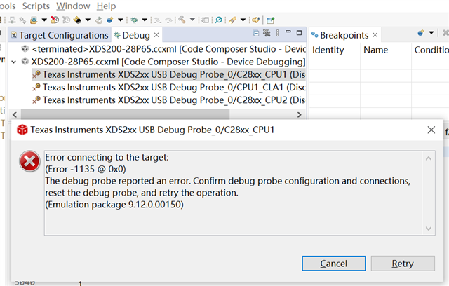

我通过添加dcsm.cmd和dcsm.asm文件来进行加密,烧录成功后,重新给板子上电,用XDS200仿真器连接,每次连接都是弹出下图的故障,请问有哪些可能或原因,谢谢

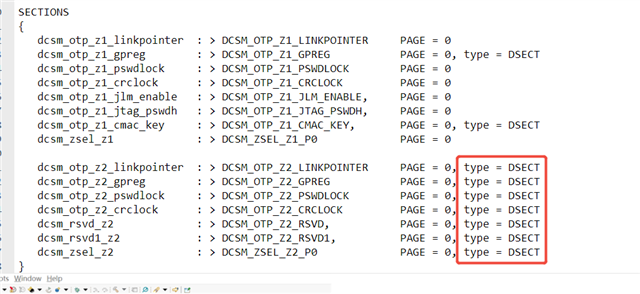

MEMORY
PAGE 0 :  /* Program Memory */
   /* Z1 OTP.  Z1 password locations / Flash and RAM partitioning */
   DCSM_OTP_Z1_LINKPOINTER     : origin = 0x78000, length = 0x00006
   DCSM_OTP_Z1_JLM_ENABLE      : origin = 0x78006, length = 0x00002
   DCSM_OTP_Z1_GPREG           : origin = 0x78008, length = 0x00008
   DCSM_OTP_Z1_PSWDLOCK        : origin = 0x78010, length = 0x00002
   DCSM_OTP_Z1_CRCLOCK         : origin = 0x78012, length = 0x00002
   DCSM_OTP_Z1_JTAG_PSWDH      : origin = 0x78014, length = 0x00004
   DCSM_OTP_Z1_CMAC_KEY        : origin = 0x78018, length = 0x00008
   /* DCSM Z1 Zone Select Contents (!!Movable!!) */
   DCSM_ZSEL_Z1_P0             : origin = 0x78020, length = 0x000020
   /* Z2 OTP.  Z2 password locations / Flash and RAM partitioning */
   DCSM_OTP_Z2_LINKPOINTER     : origin = 0x78200, length = 0x00006
   DCSM_OTP_Z2_RSVD            : origin = 0x78206, length = 0x00002
   DCSM_OTP_Z2_GPREG           : origin = 0x78208, length = 0x00008
   DCSM_OTP_Z2_PSWDLOCK        : origin = 0x78210, length = 0x00002
   DCSM_OTP_Z2_CRCLOCK         : origin = 0x78212, length = 0x00002
   DCSM_OTP_Z2_RSVD1           : origin = 0x78214, length = 0x0000C
   /* DCSM Z2 Zone Select Contents (!!Movable!!) */
   DCSM_ZSEL_Z2_P0             : origin = 0x78220, length = 0x000020
SECTIONS
   dcsm_otp_z1_linkpointer 	: > DCSM_OTP_Z1_LINKPOINTER		PAGE = 0
   dcsm_otp_z1_gpreg        : > DCSM_OTP_Z1_GPREG		    PAGE = 0, type = DSECT
   dcsm_otp_z1_pswdlock		: > DCSM_OTP_Z1_PSWDLOCK		PAGE = 0
   dcsm_otp_z1_crclock		: > DCSM_OTP_Z1_CRCLOCK			PAGE = 0
   dcsm_otp_z1_jlm_enable   : > DCSM_OTP_Z1_JLM_ENABLE,     PAGE = 0
   dcsm_otp_z1_jtag_pswdh   : > DCSM_OTP_Z1_JTAG_PSWDH,     PAGE = 0
   dcsm_otp_z1_cmac_key     : > DCSM_OTP_Z1_CMAC_KEY,       PAGE = 0, type = DSECT
   dcsm_zsel_z1				: > DCSM_ZSEL_Z1_P0				PAGE = 0
   dcsm_otp_z2_linkpointer	: > DCSM_OTP_Z2_LINKPOINTER		PAGE = 0, type = DSECT
   dcsm_otp_z2_gpreg        : > DCSM_OTP_Z2_GPREG		    PAGE = 0, type = DSECT
   dcsm_otp_z2_pswdlock		: > DCSM_OTP_Z2_PSWDLOCK		PAGE = 0, type = DSECT
   dcsm_otp_z2_crclock		: > DCSM_OTP_Z2_CRCLOCK			PAGE = 0, type = DSECT
   dcsm_rsvd_z2             : > DCSM_OTP_Z2_RSVD,           PAGE = 0, type = DSECT
   dcsm_rsvd1_z2            : > DCSM_OTP_Z2_RSVD1,          PAGE = 0, type = DSECT
   dcsm_zsel_z2				: > DCSM_ZSEL_Z2_P0				PAGE = 0, type = DSECT
