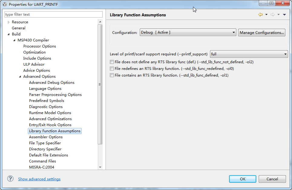

重载了printf函数,%d,%s格式都能正确输出,%f格式不能正确输出,系统不断重启,sprintf和sscanf中%s均不能正确执行,已经在Library Function Assumptions中设置Level of printf为full。

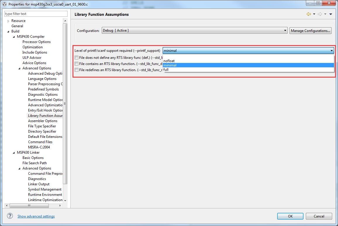

  •  可能是编译器配置问题,如下图
  • 已经在CCS中设置了如下:
    设置Level  of printf是full,但是还是不能使用%f,难道是因为MSP430G2553 Flash或者RAM资源太少不能使用%f吗?

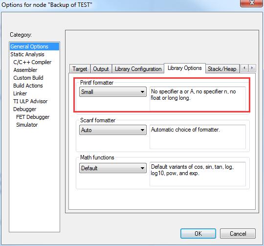

    你的第二幅截图中的Library Options设置Printf formatter是IAR软件中的设置把?

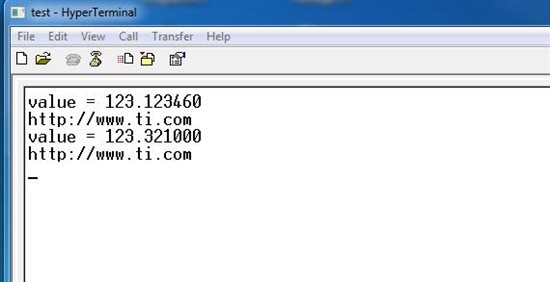

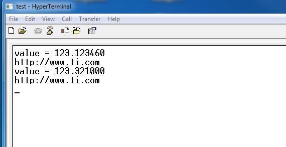

  • #include "msp430.h"
    #include "stdio.h"
    int putchar(int ch)
    	if(ch == '\n')
            UCA0TXBUF = '\r';
            while (!(IFG2&UCA0TXIFG));
        UCA0TXBUF = ch;
    	return(ch);
    void main()
        float value = 123.321;
        char *string = "http://www.ti.com";
        WDTCTL = WDTPW + WDTHOLD;
    	if (CALBC1_1MHZ==0xFF)			 // If calibration constant erased
    		while(1);                        // do not load, trap CPU!!
    	DCOCTL = 0;                               // Select lowest DCOx and MODx settings
    	BCSCTL1 = CALBC1_1MHZ;                    // Set DCO
    	DCOCTL = CALDCO_1MHZ;
    	P1SEL = BIT1 + BIT2 ;                     // P1.1 = RXD, P1.2=TXD
    	P1SEL2 = BIT1 + BIT2 ;                    // P1.1 = RXD, P1.2=TXD
    	UCA0CTL1 |= UCSSEL_2;                     // SMCLK
    	UCA0BR0 = 104;                            // 1MHz 9600
    	UCA0BR1 = 0;                              // 1MHz 9600
    	UCA0MCTL = UCBRS0;                        // Modulation UCBRSx = 1
    	UCA0CTL1 &= ~UCSWRST;                     // **Initialize USCI state machine**
        printf("value = %f\n", value);
        printf("%s\n", string);
        while(1);

  • 我是IAR的工程
