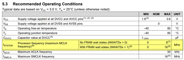

#include "driverlib.h" uint32_t clockValue; void main(void) { //Stop WDT WDT_A_hold(WDT_A_BASE); //Set DCO frequency to 16MHz CS_setDCOFreq(CS_DCORSEL_1, CS_DCOFSEL_6); CS_initClockSignal(CS_SMCLK,CS_DCOCLK_SELECT,CS_CLOCK_DIVIDER_1); CS_initClockSignal(CS_MCLK,CS_DCOCLK_SELECT,CS_CLOCK_DIVIDER_1); //Set wait state to 1 FRAMCtl_configureWaitStateControl(FRAMCTL_ACCESS_TIME_CYCLES_1); //Set P2.0 as Output Low (for setup as ACLK). /* * Select Port 2 * Set Pin 0 to output Low. */ GPIO_setOutputLowOnPin( GPIO_PORT_P3, GPIO_PIN4 ); //Set P2.0 as Ternary Module Function Output. /* * Select Port 2 * Set Pin 0 to output Ternary Module Function, (ACLK). */ GPIO_setAsPeripheralModuleFunctionOutputPin( GPIO_PORT_P3, GPIO_PIN4, GPIO_TERNARY_MODULE_FUNCTION ); /* * Disable the GPIO power-on default high-impedance mode to activate * previously configured port settings */ PMM_unlockLPM5(); while(1); }
