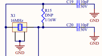

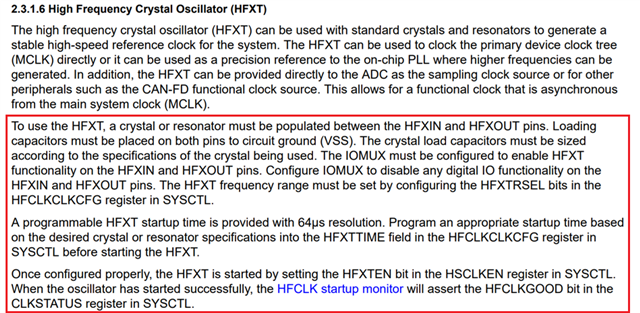

I am working on MSPM0G3519 controller(32 pin) and trying to start external crystal 16MHz, but it stuck at the below line:
You can check the hardware design for crystal connection(HFIN connect at PTA5 and HFOUT connected at PTA6) :
Please check the attached configuration and help us to resolve the issue.
thank you.

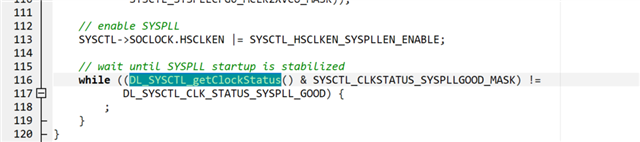

SYSCONFIG_WEAK void SYSCFG_DL_SYSCTL_init(void)
	//Low Power Mode is configured to be SLEEP0
    DL_SYSCTL_setBORThreshold(DL_SYSCTL_BOR_THRESHOLD_LEVEL_0);
    DL_SYSCTL_setFlashWaitState(DL_SYSCTL_FLASH_WAIT_STATE_2);
    DL_SYSCTL_setSYSOSCFreq(DL_SYSCTL_SYSOSC_FREQ_BASE);
    /* Set default configuration */
    DL_SYSCTL_disableHFXT();
    DL_SYSCTL_disableSYSPLL();
    DL_SYSCTL_setHFCLKSourceHFXTParams(DL_SYSCTL_HFXT_RANGE_8_16_MHZ, 10, false);
    DL_SYSCTL_configSYSPLL((DL_SYSCTL_SYSPLLConfig *) &gSYSPLLConfig);
    DL_SYSCTL_setULPCLKDivider(DL_SYSCTL_ULPCLK_DIV_1);
    DL_SYSCTL_setMCLKSource(SYSOSC, HSCLK, DL_SYSCTL_HSCLK_SOURCE_SYSPLL);
    DL_SYSCTL_setMCLKDivider(DL_SYSCTL_MCLK_DIVIDER_DISABLE);
SYSCONFIG_WEAK void SYSCFG_DL_SYSCTL_CLK_init(void) {
    while ((DL_SYSCTL_getClockStatus() & (DL_SYSCTL_CLK_STATUS_SYSPLL_GOOD
		 | DL_SYSCTL_CLK_STATUS_HFCLK_GOOD
		 | DL_SYSCTL_CLK_STATUS_HSCLK_GOOD
		 | DL_SYSCTL_CLK_STATUS_LFOSC_GOOD))
	       != (DL_SYSCTL_CLK_STATUS_SYSPLL_GOOD
