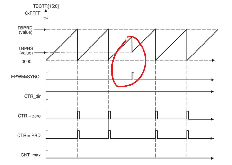

SYSCONFIG: The issue of refreshing the ePWM1 counter via ZCD (inductor current)
Part Number: SYSCONFIG

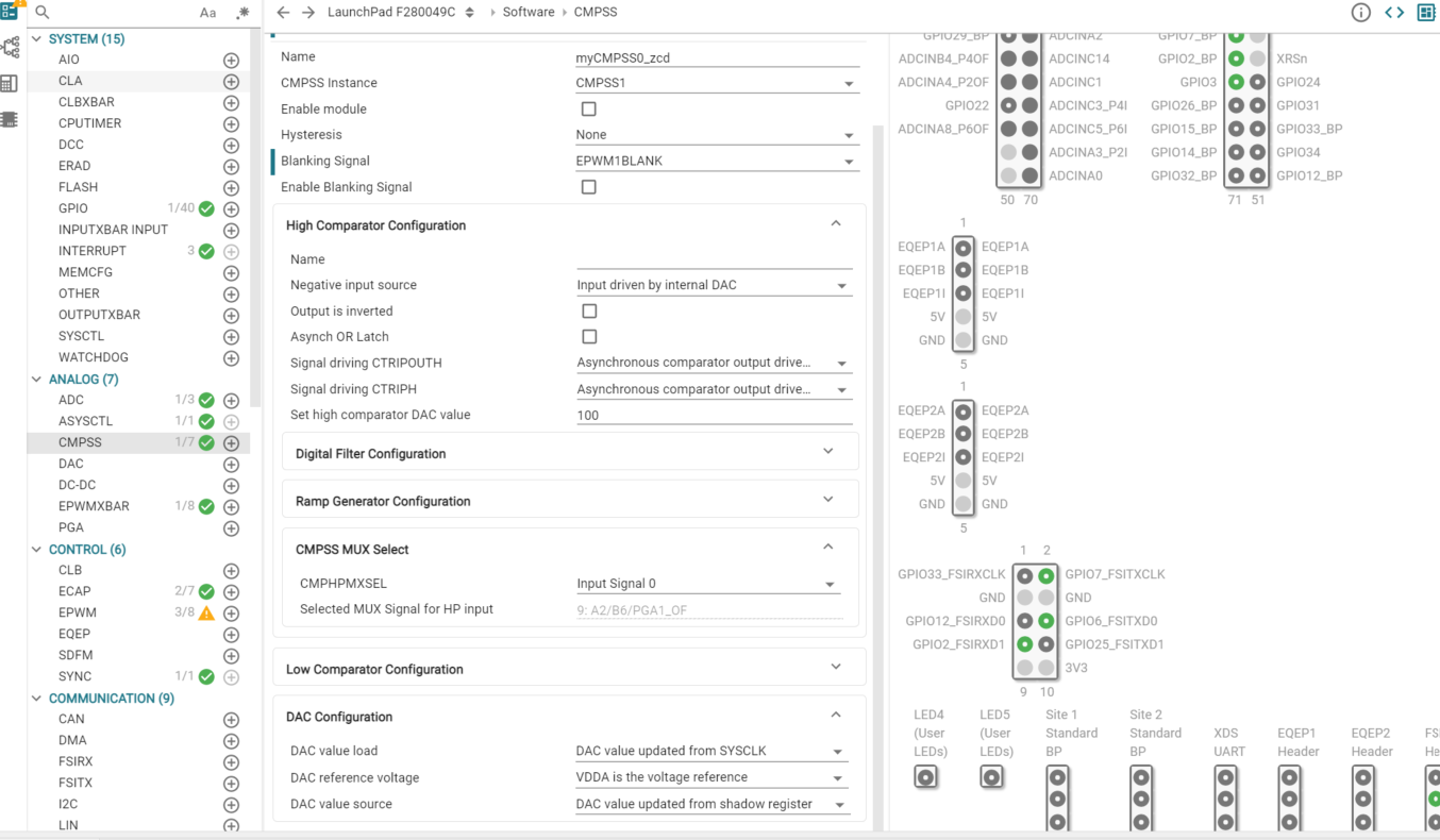

when the inductor current is greater than 0, the CMPSS pin inputs a high level (1); when the inductor current is less than 0, the CMPSS pin inputs a low level (0). The ePWM1 counter is refreshed when the CMPSS comparison value transitions from 1 to 0.
Could you help check if the configuration here is correct?

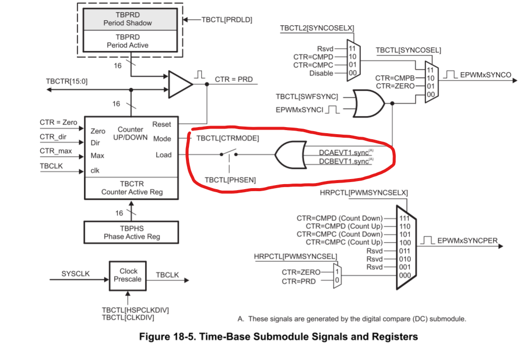

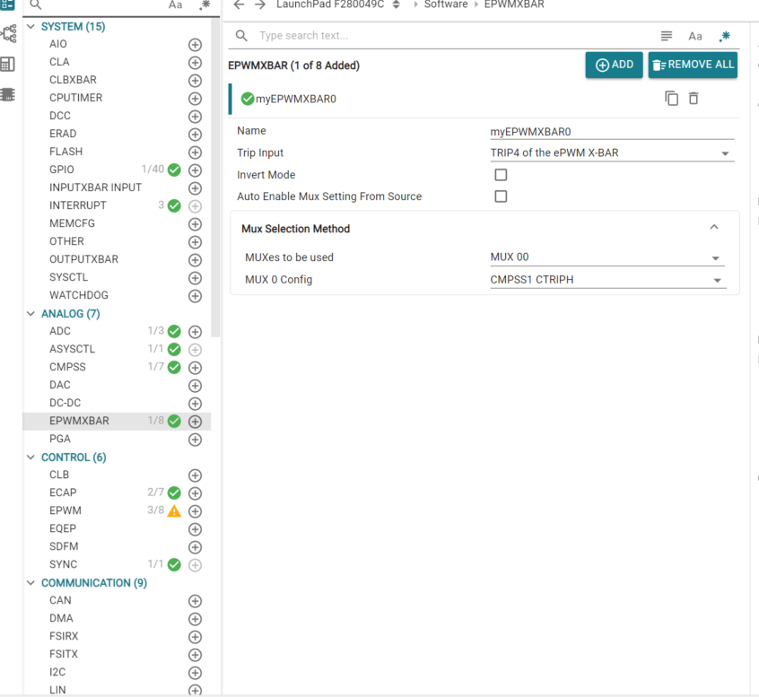

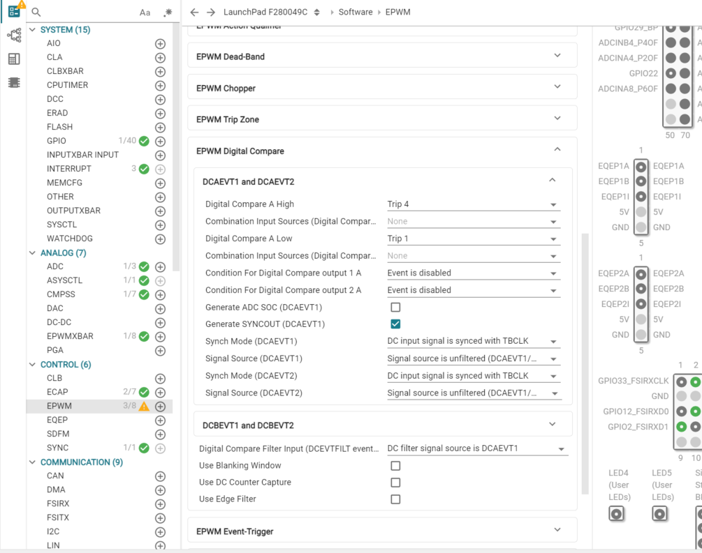

My approach is: CMPSS → ePWM X-Bar → ePWM1. When ZCD is generated, DCAEVT1.sync is triggered; configure TBPHS=0 to reset the counter.
But does this TBPHS need to be filled in manually?

    EPWM_selectDigitalCompareTripInput(myEPWM1_BASE, EPWM_DC_TRIP_TRIPIN4, EPWM_DC_TYPE_DCAH);
    EPWM_enableDigitalCompareSyncEvent(myEPWM1_BASE, EPWM_DC_MODULE_A);

void EPWMXBAR_init(){
	myEPWMXBAR0_init();
void myEPWMXBAR0_init(){
	XBAR_setEPWMMuxConfig(myEPWMXBAR0, XBAR_EPWM_MUX00_CMPSS1_CTRIPH);
	XBAR_enableEPWMMux(myEPWMXBAR0, XBAR_MUX00);
