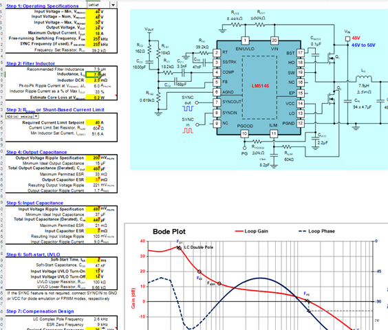

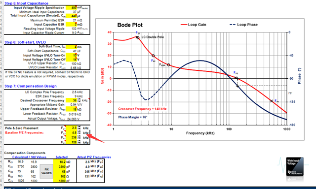

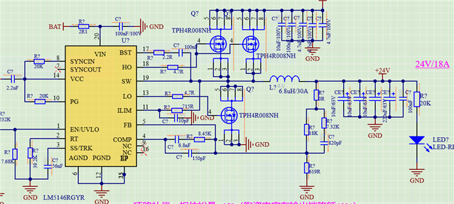

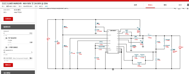

需求VIN :48V VOUT :24V 18A,请帮忙看一下方案原理图设计以及环路参数
输出电容10uF(0.88Ω)×3 470uf 0.043Ω, 电感没找到合适型号
Inductor is fine (30% ripple current), but the output cap ESR seems very high at 37mΩ (even given the high Cout of 480uF). As mentioned, 4pcs of 10uF/50V ceramic output cap is fine (maybe add a 47uF/50V polymer electrolytic with low ESR if needed for better transient response). Set the loop with the recommended components from the quickstart.
