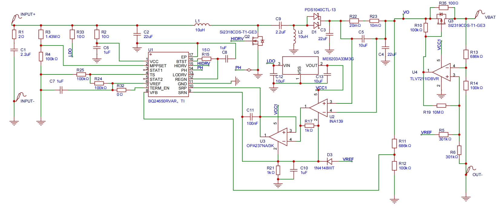

您好:
关于sepic太阳能充电器,我使用的是bq24650的SEPIC方案进行设计,参考的是BQ24650 设计参考示例.pdf ,但却无法实现正常充电。
我的电路板输入设置在10~28V,输出限制16.4V或以下, 16.5时输出截止。但在实际测试中,测得开路输出电压和电流为0,即便接上电池也是如此
您好
Please refer to schematic checklist:BQ24610_BQ24650_Schematic_Checklist (1).pdf
You are missing the lowside MOSFET and the L2 is tied to GND.
Thanks for your reply. However, I designed this based on TI's official sample document(A solar-powered buck/boost battery charger)—there’s no lowside MOSFET in the reference schematic of that document either, and the inductor L2 is also tied directly to GND there.
您好
What is the voltage on the MPPSET Pin?
What is the voltage on the VCC Pin?
What is the voltage on the Vref Pin?
What is the voltage on the REGN Pin?
What is the voltage on the TS Pin?
Is battery shorted to GND?
You should see the battery voltage on Vo.
