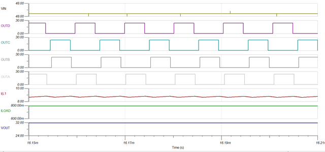

I am simulating a PSFB converter using UCC28950 in TINA-TI. My input voltage range is 43V to 58V and output voltage is 240-385V ,output power is 4KW. I am seeing an issue with the simulation output. The converter  output voltage goes to 12V instead of 385V.
Issue: The output voltage doesnot change,It remains on 12V
Expected behavior: The converter should regulate at 365V as per the design tool for an input of 48 V.

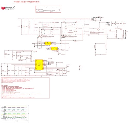

  • Hi,
    This is the schematic diagram.

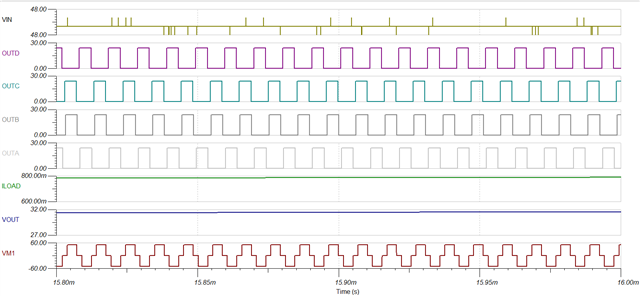

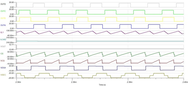

  • Please find attached the schematic and waveforms for the primary current, bridge switch VDS, secondary output voltage, CS output, and output load current.
    Update-
    -The compensation values were updated as suggested; however, the output voltage rises to 12 V .
    -The CT output does not follow the main current, as shown in the waveforms.
    -I also simulated with peak current mode control disabled by connecting the Rsum pin to Vref through the Rsum resistor, but the issue still persists.
    Please let me know your feedback.
    Thank you
  • 您好
    您的二次电压与预期不符,匝数比为8:100时二次电压应该更高。48个输入的次级峰值电压应为600V,而不是20V。这可能是因为匀场电感器(L2)。您使用了26uF的匀场电感(值甚至超过磁化电感),根据您的计算器,初级侧不需要匀场电感。只需缩短匀场电感或使用非常低的电感值,然后再次尝试模拟。这将解决你的问题。

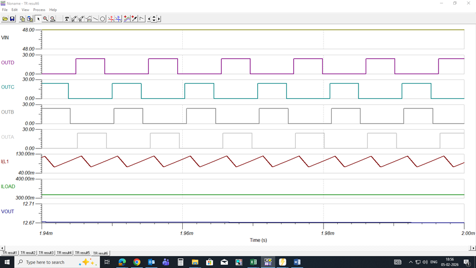

    Thank you for your suggestion.
    I removed the 26 µH shunt  inductor from the primary side and re-ran the simulation as recommended. However, the secondary voltage still does not boost as expected. The output remains low, and the issue persists even without the balancing inductor in place.
  • 您好

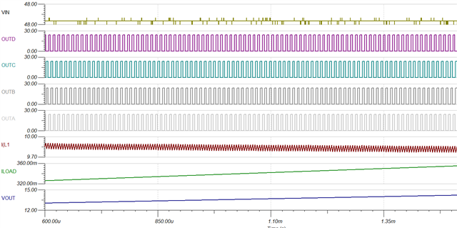

    In the latest waveforms, the output voltage and current appear to be building up, and the soft start is set to 15 ms. However, the measurement was taken at 1 ms. Could you please confirm whether the voltage is still not building up even after 15 ms?
    To help narrow down the debugging process, could you please check the output voltage of the full bridge with respect to the secondary output voltage? This will help verify whether the input voltage is being properly transferred to the secondary side. If it is not, then the issue is related to the transformer magnetics
  • Hello,
    Output voltage is 32V   even after 15 ms.

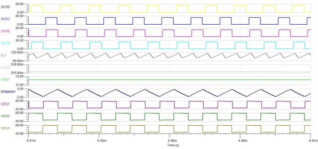

  • Hi,
    VM1 is the output voltage of the full-bridge converter, referenced to the transformer’s secondary output voltage.
    Does this issue related to the transformer magnetics? If so, what will do? Could you please suggest a possible solution?

    Just noticed few things in schematic: -
    In Lout property DCR is 50M, mean 50mega ohm, which is too high, change this to 50m (50mili).
    Leakage of transformer is also high (almost 10% of Lm). Decrease the leakage or increase Lm to 100uH.
  • Hello,
    Lout DCR changed to 50mohm and leakage inductance Lm to 100uH.There is no boost in the output voltage

  • Hi
    I am running simulation and did some changes in converter parameter and now output voltage has increased to 260V before reaching steady state as simulation is taking long time to complete. By some reason peak current mode was not working now i'm running into VCM and it's working.
    Here is updated TINA model.8311.PSFB4kwtina_updated.TSC
