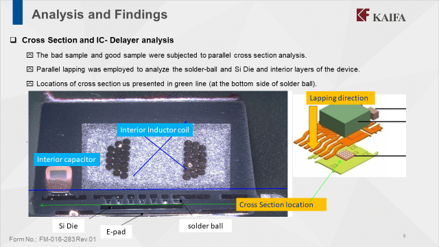

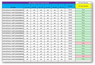

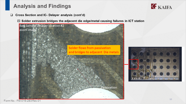

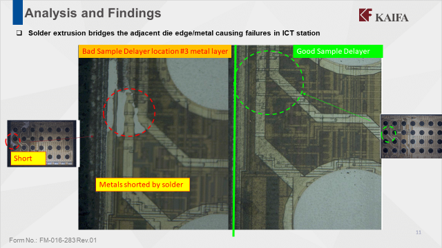

We found that there is failure on ICT test on MPN: LMZ14201TZX-ADJ/NOPB. Kindly help to provide the RMA# to send 3pcs failure part for FA. Below is the detail.
  • Failure: VCC power Test failed for 3v3.
  • D/C: 2138
  • Reject rate : 17/31 board fail (54.8%) failure
