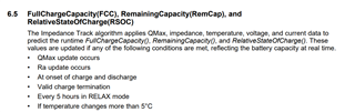

Without seeing a .log file of discharge and charge cycle is it is really hard to pinpoint a solution without it being a shot in the dark. The least likely but still a good place to start is your chemID, could you attached your GPCCHEM report to verified that your chemID option are below 3%. The best suggestion would be to look at section 6.5 of the Technical Reference Manual to see how each part plays within FCC. The other possible issues that the FCC could stem from is if your team manipulated/ not following the procedure for the learning cycle.
Technical Reference Manual:
https://www.ti.com/lit/ug/sluubk0b/sluubk0b.pdf?ts=1744648456038&ref_url=https%253A%252F%252Fwww.ti.com%252Fproduct%252FBQ40Z50-R2
BQ40Z50 Setup and Going to Production:
https://www.ti.com/video/5833131913001
*Qmax is created after learning cycle, Ra tables are based on chemID
