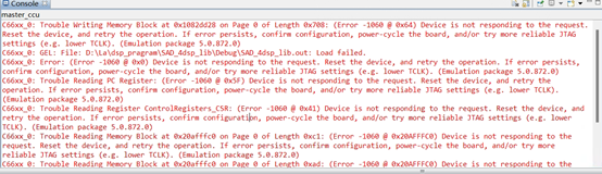

C6678的core1~7核加载成功;但core0加载失败,不清楚什么原因;请尽快协助分析和解决:

Katherine Wang 您好!
感谢您的回复,现在出问题的不是TI TI-C6678 EVM,是我们自己设计一个板卡;
出现这样的问题,需要排查哪些哪些设计点?
原理图设计上主要排查哪些点?
PCB设计上主要排查哪些点?
软件代码上需要排查哪些点?

首先请按照此处给出的步骤执行“测试连接过程”,然后将输出控制台消息发布给我。
C6678 EVM 和 TEST -CONNECTION 选项的 cxml 文件设置:
CCS中的测试连接输出:
完成 - 成功的 JTAG 连接输出将如下所示:
The JTAG IR instruction path-length is 6 bits. The test for the JTAG DR bypass path-length succeeded. The JTAG DR bypass path-length is 1 bits. -----[Perform the Integrity scan-test on the JTAG IR]------------------------ This test will use blocks of 64 32-bit words. This test will be applied just once. Do a test using 0xFFFFFFFF. Scan tests: 1, skipped: 0, failed: 0 Do a test using 0x00000000. Scan tests: 2, skipped: 0, failed: 0 Do a test using 0xFE03E0E2. Scan tests: 3, skipped: 0, failed: 0 Do a test using 0x01FC1F1D. Scan tests: 4, skipped: 0, failed: 0 Do a test using 0x5533CCAA. Scan tests: 5, skipped: 0, failed: 0 Do a test using 0xAACC3355. Scan tests: 6, skipped: 0, failed: 0 All of the values were scanned correctly. The JTAG IR Integrity scan-test has succeeded. -----[Perform the Integrity scan-test on the JTAG DR]------------------------ This test will use blocks of 64 32-bit words. This test will be applied just once. Do a test using 0xFFFFFFFF. Scan tests: 1, skipped: 0, failed: 0 Do a test using 0x00000000. Scan tests: 2, skipped: 0, failed: 0 Do a test using 0xFE03E0E2. Scan tests: 3, skipped: 0, failed: 0 Do a test using 0x01FC1F1D. Scan tests: 4, skipped: 0, failed: 0 Do a test using 0x5533CCAA. Scan tests: 5, skipped: 0, failed: 0 Do a test using 0xAACC3355. Scan tests: 6, skipped: 0, failed: 0 All of the values were scanned correctly. The JTAG DR Integrity scan-test has succeeded. [End: Texas Instruments XDS100v1 USB Debug Probe_0]
