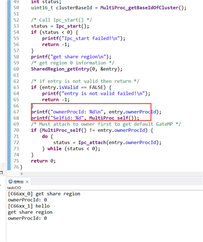

目前创建了两个工程,一个核0,一个核1,核0与核1之间通过ipc模块使用共享内存区域SharedRegion,调用MessageQ接口进行消息传递,若两个代码放在L2SRAM中运行,则能够正常运行;若将代码等段,通过cfg配置到DDR3中,则会出现无法attach状况,如下图所示,两个核一直无法互相attach上。

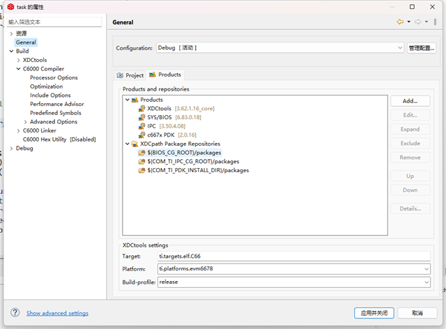

目前使用的版本信息如下:
核0代码如下:
/* * ======== mutex.c ======== * This example shows the use of two tasks and one semaphore to perform * mutual exclusive data access. */ #include <stdio.h> #include <xdc/std.h> #include <xdc/runtime/System.h> #include <ti/sysbios/BIOS.h> #include <ti/sysbios/knl/Clock.h> #include <ti/sysbios/knl/Task.h> #include <ti/sysbios/knl/Semaphore.h> #include <xdc/cfg/global.h> #include "coremessage/coreipc.h" Void task1(UArg arg0, UArg arg1); Int resource = 0; Task_Handle tsk1; extern MessageQ_Handle messageQ; /* * ======== main ======== */ int main() { Task_Params taskParams; /* Create a Semaphore object to be use as a resource lock */ InitIpc(); /* Create two tasks that share a resource*/ Task_Params_init(&taskParams); taskParams.priority = 1; tsk1 = Task_create (task1, &taskParams, NULL); BIOS_start(); /* does not return */ return(0); } /* * ======== task1 ======== */ void task1(UArg arg0, UArg arg1) { CoreMsg *msg; AttachCore(1); RegisterMem(0); MessageCreate(); for (;;) { printf("Running core0 function\n"); MessageGet(messageQ, (MessageQ_Msg*)&msg); printf("src:%d, flags:%d, numMsgs:%d, seqNum:%d, heartbeat:%d \n", msg->src, msg->flags, msg->numMsgs, msg->seqNum, msg->heartbeat); MessageFree((MessageQ_Msg)msg); Task_sleep(1000); } }
核1代码如下:
/* * ======== mutex.c ======== * This example shows the use of two tasks and one semaphore to perform * mutual exclusive data access. */ #include <stdio.h> #include <xdc/std.h> #include <xdc/runtime/System.h> #include <ti/sysbios/BIOS.h> #include <ti/sysbios/knl/Clock.h> #include <ti/sysbios/knl/Task.h> #include <ti/sysbios/knl/Semaphore.h> #include <xdc/cfg/global.h> #include "coremessage/coreipc.h" Void task1(UArg arg0, UArg arg1); Task_Handle tsk1; extern MessageQ_Handle messageQ; /* * ======== main ======== */ int main() { Task_Params taskParams; /* Create a Semaphore object to be use as a resource lock */ InitIpc(); /* Create two tasks that share a resource*/ Task_Params_init(&taskParams); taskParams.priority = 1; tsk1 = Task_create (task1, &taskParams, NULL); BIOS_start(); /* does not return */ return(0); } /* * ======== task1 ======== */ void task1(UArg arg0, UArg arg1) { CoreMsg *msg; int i = 0; MessageQ_QueueId QueueId; AttachCore(0); RegisterMem(0); MessageOpen(0, &QueueId); for (;;) { msg = MessageAlloc(0); printf("Running core1 function\n"); msg->src = 1; msg->flags = 0x12; msg->heartbeat = 10 + i; msg->numMsgs = 1; msg->seqNum = i+1; MessagePut(QueueId, (MessageQ_Msg)msg); i++; Task_sleep(1000); } }
核0,cfg文件:
核1,cfg文件:
您好,
有许多不同版本的 SDK 包。您是否方便具体说一下:
1. 软件包的名称
2. 软件包的版本
3. example的名称
这将有助于我们更深入地了解您的问题。 非常感谢!
