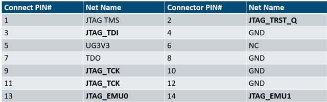

我们给SOC AM62A74的JTAG 连接如下

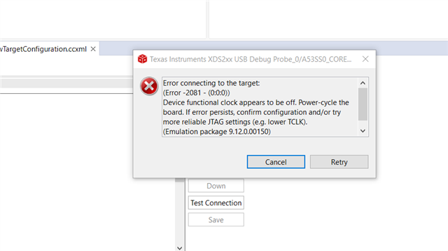

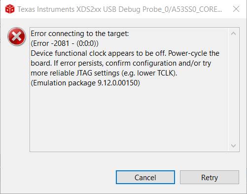

我们的板子是自己开发的,SOC内部现在是没有任何程序的。 时钟在硬件配置上正常,电源供电已经完成。

请看一下是否有按照下面的电路图连接?
Target Connection Design
https://dev.ti.com/tirex/explore/node?node=AOi9Jj0vmBMJ0KQKaKITgg__FUz-xrs__LATEST

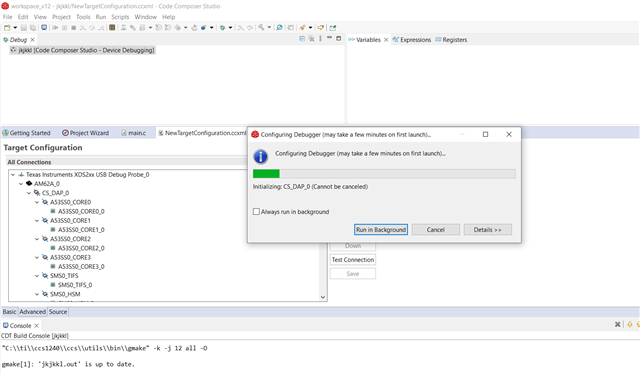

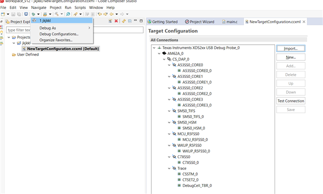

I close it. And run debug like below:
1.
2. The process will run like below:
3. Then I'll be indicated with below picture:
Could you know what has happened basing on these information ?
Thank you,
请尝试 下面的帖子里的方法,问题类似。
The inability to connect to the cores may result from not initializing the board. Have you made sure the board is properly initialized may be with SBL NULL bootloader from AM62A MCU+ SDK

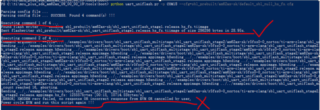

Currently the CCS can't let the UART port work for we can't measure the output in the UART TX when we run the configuration file in CCS.
那要检查一下uart串口的硬件电路了。先通过uart口烧写SBL NULL bootloader ,再连接JTAG。
请配置成uart boot mode,然后看有没有cccc打印出来,看板子的串口是否通的。
