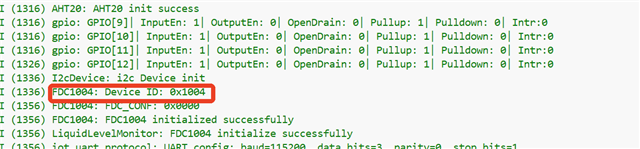

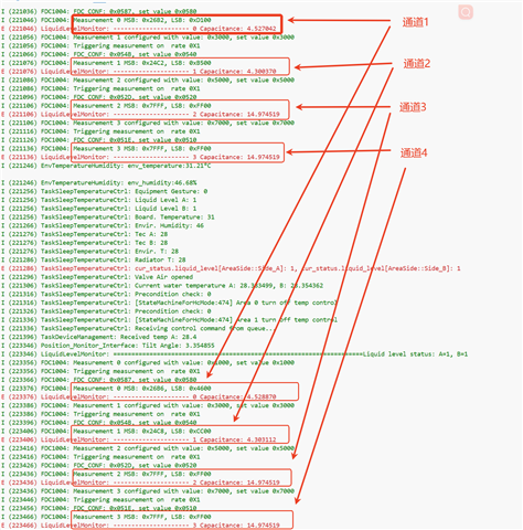

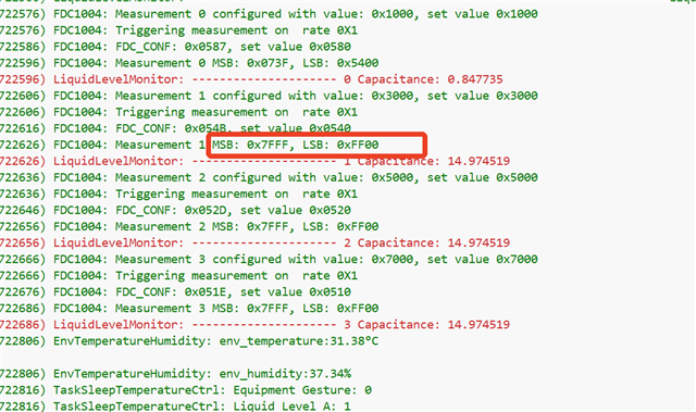

I am new to FDC1004, i am using FDC1004 with ESP-32 with I2C in single measurement mode. But MEAS*_MSB registers always returns fixed value0X7FFF. My code is same as the related question:
FDC1004 returns fixed value - Sensors forum - Sensors - TI E2E support forums

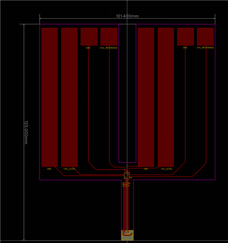

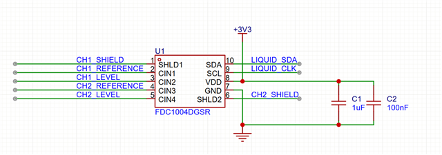

    (1)pcb picture as follows:
    (2)source code:
    A. fdc1004_dreiver.c:

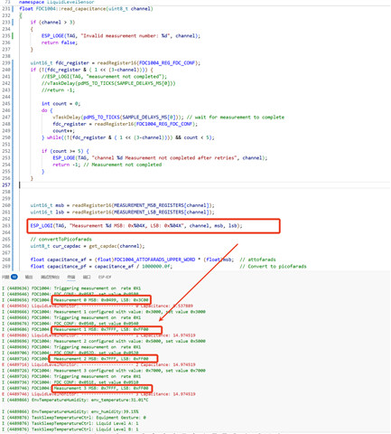

    float FDC1004::read_capacitance(uint8_t channel)
        if (channel > 3)
            ESP_LOGE(TAG, "Invalid measurement number: %d", channel);
            return false;
        uint16_t fdc_register = readRegister16(FDC1004_REG_FDC_CONF);
        if (!(fdc_register & ( 1 << (3-channel)))) {
            //ESP_LOGI(TAG, "measurement not completed");
            //vTaskDelay(pdMS_TO_TICKS(SAMPLE_DELAYS_MS[0]))
            //return -1;
            int count = 0;
            do {
                vTaskDelay(pdMS_TO_TICKS(SAMPLE_DELAYS_MS[0])); // wait for measurement to complete
                count++;
            } while((!(fdc_register & ( 1 << (3-channel)))) && count < 5);
            if (count >= 5) {
                ESP_LOGE(TAG, "channel %d Measurement not completed after retries", channel);
                return -1; // Measurement not completed
        uint16_t msb = readRegister16(MEASUREMENT_MSB_REGISTERS[channel]);
        uint16_t lsb = readRegister16(MEASUREMENT_LSB_REGISTERS[channel]);
        ESP_LOGI(TAG, "Measurement %d MSB: 0x%04X, LSB: 0x%04X", channel, msb, lsb);

    *********NOTES: The print info in the above code correspons to the following picture:
  • 您好,
          请通过读取芯片的Device ID(0x1004)来判断芯片是否工作以及验证I2C时序。
  • 1,读取MEAS*_MSB寄存器之前,已经通过读取Device ID为0x1004,判断i2c时序了
    2,循环读取了MEAS1_MSB,MEAS2_MSB,MEAS3_MSB和MEAS4_MSB四个通道的寄存器的值了,
    其中通道MEAS1和MEAS3,在电路中都是作为reference sensor,通道MEAS2和MEAS4,在电路中都是作为liquid sensor,
    通道MEAS1和MEAS2读取到的值时动态变化的,但是MEAS3和MEAS4从设备上电后读取的值就是固定的0X7FFF.
    如果i2c时序不正常,我的软件程序会reset的,实际没有reset同时能够读取4个通道MEAS*的值,说明i2c时序时正常的。
  • 您好,
         对于单端4通道采样,各通道寄存器配置是类似的。
         您是否在硬件连接上交换通道测试过?通道1<->通道3    通道2<->通道4
