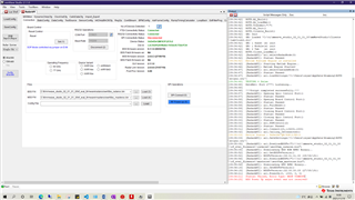

2、我使用IWR6843AOP+MMWAVEICBOOST+DCA1000进行原始数据采集,sop配置为debug模式,MMWAVEICBOOST模式是DCA1000 mode,在mmwave studio中配置过程中spi connect失败,请问要怎么解决?
1. 需要。
2. 请贴一下mmwave studio报错图。另外请看一下板子的拨位开关是否按照Figure 2-12. IWR6843ISK-MMWAVEICBOOST-DCA1000EVM Test Setup和Figure 4-15. Switch Configuration for MMWAVEICBOOST Mode配置的?
请尝试下面帖子里的方法。
For AOP board, before loading the firmware, after rest and connect RS232, please manually
1) step 1: click on 60G
2) step 2: clock on xwr6843
Then load the firmware after that. That should solve your problem
https://e2e.ti.com/support/sensors-group/sensors/f/sensors-forum/935894/iwr6843aopevm-timeout-during-spi-connect-in-mmwave-studio
