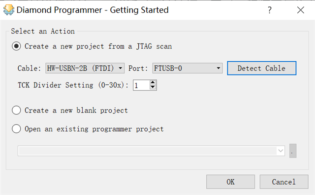

点开软件的Getting Started窗口设置如下:

  • 手动选择。
    3. If the command line prompts to select the device manually, then click on the Device column and select the LFE5UM-85F device.

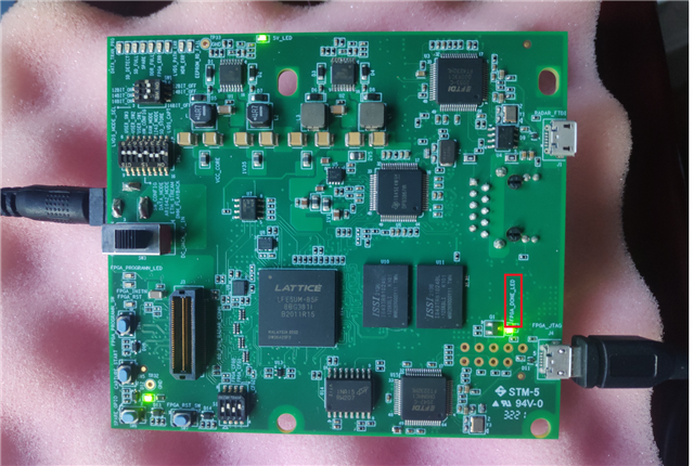

    第三个问题:FPGA DONE LED (LD14)在板子哪里?我没有找到。
  • 1. 直接到mmwave studio按照路径下选择,2.1版本的在PlatformBinaries目录下。
    2. 会替代掉原来的。output窗口里有烧写提示信息。
    3. 下面图中红色方框。
  • 您好,我的结果栏从头到尾的显示如下:
    Lattice VM Drivers detected (HW-DLN-3C (Parallel), HW-USBN-2B (FTDI))
    INFO - Scanning USB2 Port FTUSB-0...
    Programmer device database loaded
    INFO - Scan completed successfully.
    WARNING - Scan found ECP5UM on row 1 but cannot identify the package. Please manually select the correct device before proceeding.
    ERROR - JEDEC file cannot be found.
    ERROR - Check configuration setup: Unsuccessful.
    INFO - Check configuration setup: Start.
    INFO - JTAG Chain Verification. No Errors.
    INFO - Check configuration setup: Successful.
    INFO - Device1 LFE5UM-85F: Erase Only
    INFO - Operation Done. No errors.
    INFO - Elapsed time: 00 min : 01 sec
    INFO - Operation: successful.
    INFO - Device1 LFE5UM-85F: N25Q128A: SPI Flash Erase,Program,Verify
    Initializing...
    IDCode Checking...
    Enabling...
    Erasing...
    Disabling...
    Enabling...
    Programming...
    Disabling...
    Verifying...
    INFO - Execution time: 00 min : 18 sec
    INFO - Operation successful with 0xF65D checksum.
    INFO - Elapsed time: 00 min : 18 sec
