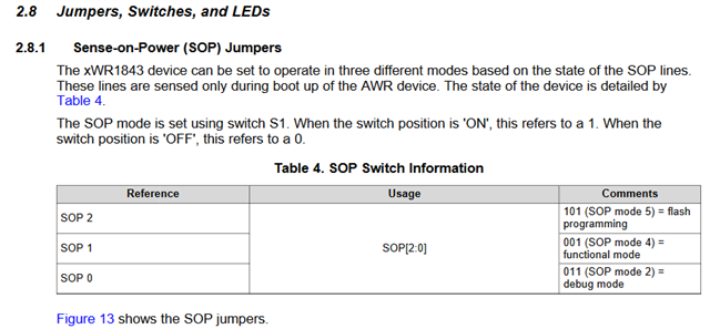

一样的,也是011,请参考AWR1843BOOST开发板文档Table 4. SOP Switch Information
https://www.ti.com/lit/ug/spruim4b/spruim4b.pdf
