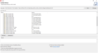

请不要勾选下面的2项
编译器的选择安装的话,请参考文档
http://software-dl.ti.com/ccs/esd/documents/ccs_compiler-installation-selection.html

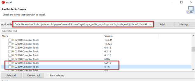

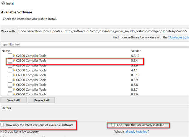

我之前的截图就是使用CCS 6.2和 CCS10,理论上都是包含的。若是可以的话,您可以尝试更新CCS版本
Code Generation Tools Updates - http://software-dl.ti.com/dsps/dsps_public_sw/sdo_ccstudio/codegen/Updates/p2win32/
您不要选择help,而需要选下面的

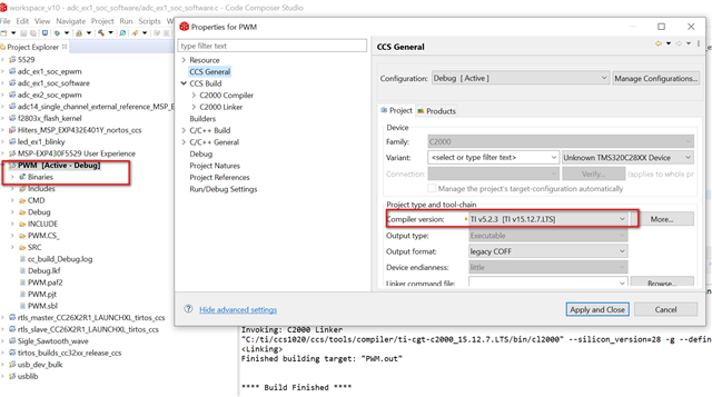

您好,我去嘗試編譯是可以成功的,但是請注意他有三角形的黃色警告,
This project was created using a version of compiler that is not currently installed: 5.2.3 [C2000]. Another version of the compiler will be used during build: 6.4.6. Please go to <a href="liveaction:OpenAppCenter">CCS App Center</a> to install the compiler of the required version, or migrate the project to one of the available compiler versions by adjusting project properties.
我認為會導致我連接F28335時,板子亮紅燈LD2
