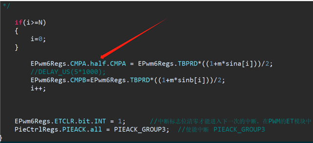

When using TMS320F28335, you want to use the monitoring window to view the value of EPwm6Regs.CMPA.half.CMPA, and then use the "Graph" function of CCS software to view the waveform after EPwm6Regs.CMPA.half.CMPA.
The ideal waveform of EPwm6Regs.CMPA.half.CMPA should be a sine wave on the 0 scale line. I observed this waveform with an oscilloscope.
In fact, when I use "step into", the value of EPwm6Regs.CMPA.half.CMPA increases normally, and the output waveform with "Graph" is also normal. However, when I use "resume" for operation debugging, The change of the value of EPwm6Regs.CMPA.half.CMPA cannot be seen in the monitoring window, and the output waveform is no longer an ideal sine wave.
I wonder why this is the case, and hope to get some help.
I have attached the code I am using below.
main.c

	EPwm6Regs.CMPA.half.CMPA = 0;    // Set compare A value
	EP
EPwm6Regs.CMPA.half.CMPA value calculation formula:
