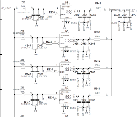

Hello TI expert, I have 2 questions about REF54500CDR.
1. Does REF54500CDR support several IC output in parallel so that we can get a 5V output with much lower noise than a single REF54500CDR output.
