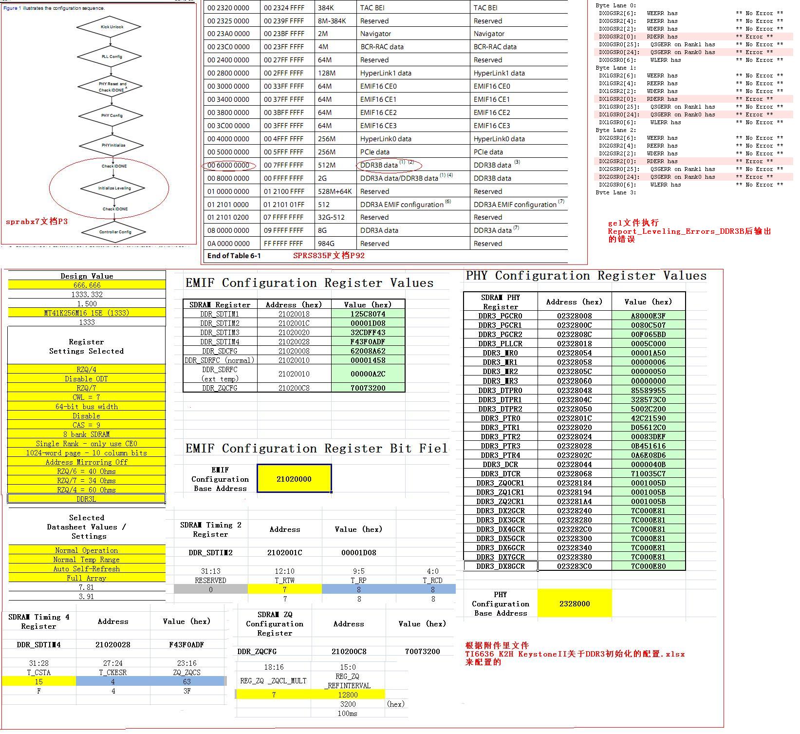

    根据TI的SPRS835F手册,DDR3B的地址在0x60000000可以访问,我目前硬件 DDR3A_REMAP_EN=1。想请高手帮着看看是DDR3B哪里配置不正确。根据配置流程,进行leveling,但是在执行leveling后,没有完全正确。
    我参考sprabx7文档中DDR3的流程,有leveling的错误log。目前DDR3B的phy的配置是根据(TI6636 K2H KeystoneII关于DDR3初始化的配置.xlsx)来配置的。 目前硬件测试了时钟,是666MHz,波形良好,片选上有信号,DDR3B上电压是1.5V。DDR3B执行leveling之前DDR3B_PGSR0 = 0xB00001FF,执行leveling之后是DDR3B_PGSR0 = 0xB1C001FF,可以看附件里的DDR3A和DDR3B的gel的log(我尝试修改了phy的配置,最终现象一致,还是RDERR has ERROE)。

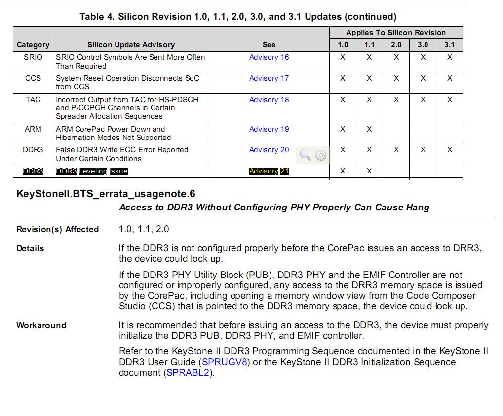

我从勘误表中找到的,目前我芯片使用的版本是CPU: 66AK2Hx SR2.0, 其中Advisory21应该针对2.0不受影响,目前遇到的问题类似KeyStoneII.BTS_errata_usagenote.6,我按照手册以及xls的配置,不知道Phy配置是否合适。想咨询下,看能否提供一些支持或者建议。
gel文件中DDR3B的执行,寄存器的基地址以及偏移都是对的。

arm_A15_0: GEL Output: DDR3B PLL Setup ...
arm_A15_0: GEL Output: Lammar DDR3 PLL Setup complete, DDR3B clock now running at 666MHz.
arm_A15_0: GEL Output: DDR3B_DCR = 0x0000040B
arm_A15_0: GEL Output: DDR3B_DATX8_8 Front = 0xB000000F
arm_A15_0: GEL Output: DDR3B_DATX8_8 rear = 0xB000000E
arm_A15_0: GEL Output: DDR3B_PGSR0 = 0xB1C001FF
arm_A15_0: GEL Output: DDR3B_PGSR1 = 0x00000000
arm_A15_0: GEL Output: DDR3B 1333M initialization complete
arm_A15_0: GEL Output: ****************************************************************************************************************
arm_A15_0: GEL Output: ***************** DDR3B Leveling Errors *********************
arm_A15_0: GEL Output: PGSR0[27]: WEERR has ** No Error **
arm_A15_0: GEL Output: PGSR0[26]: REERR has ** No Error **
arm_A15_0: GEL Output: PGSR0[25]: WDERR has ** No Error **
arm_A15_0: GEL Output: PGSR0[24]: RDERR has ** Error **
arm_A15_0: GEL Output: PGSR0[23]: WLAERR has ** Error **
arm_A15_0: GEL Output: PGSR0[22]: QSGERR has ** Error **
arm_A15_0: GEL Output: PGSR0[21]: WLERR has ** No Error **
arm_A15_0: GEL Output: PGSR0[20]: ZCERR has ** No Error **
arm_A15_0: GEL Output: PGSR0[11]: WEDONE is ** Not Set **
arm_A15_0: GEL Output: PGSR0[10]: REDONE is ** Not Set **
arm_A15_0: GEL Output: PGSR0[9]: WDDONE is ** Not Set **
arm_A15_0: GEL Output: PGSR0[8]: RDDONE is ** Set **
arm_A15_0: GEL Output: PGSR0[7]: WLADONE is ** Set **
arm_A15_0: GEL Output: PGSR0[6]: QSGDONE is ** Set **
arm_A15_0: GEL Output: PGSR0[5]: WLDONE is ** Set **
arm_A15_0: GEL Output: PGSR0[4]: DIDONE is ** Set **
arm_A15_0: GEL Output: PGSR0[3]: ZCDONE is ** Not Set **
arm_A15_0: GEL Output: PGSR0[2]: DCDONE is ** Set **
arm_A15_0: GEL Output: PGSR0[1]: PLDONE is ** Set **
arm_A15_0: GEL Output: PGSR0[0]: IDONE is ** Set **
arm_A15_0: GEL Output: Leveling Errors by Byte Lane:
arm_A15_0: GEL Output: Byte Lane 0:
arm_A15_0: GEL Output: DX0GSR2[6]: WEERR has ** No Error **
arm_A15_0: GEL Output: DX0GSR2[4]: REERR has ** No Error **
arm_A15_0: GEL Output: DX0GSR2[2]: WDERR has ** No Error **
arm_A15_0: GEL Output: DX0GSR2[0]: RDERR has ** Error **
arm_A15_0: GEL Output: DX0GSR0[25]: QSGERR on Rank1 has ** No Error **
arm_A15_0: GEL Output: DX0GSR0[24]: QSGERR on Rank0 has ** Error **
arm_A15_0: GEL Output: DX0GSR0[6]: WLERR has ** No Error **
arm_A15_0: GEL Output: Byte Lane 1:
arm_A15_0: GEL Output: DX1GSR2[6]: WEERR has ** No Error **
arm_A15_0: GEL Output: DX1GSR2[4]: REERR has ** No Error **
arm_A15_0: GEL Output: DX1GSR2[2]: WDERR has ** No Error **
arm_A15_0: GEL Output: DX1GSR2[0]: RDERR has ** Error **
arm_A15_0: GEL Output: DX1GSR0[25]: QSGERR on Rank1 has ** No Error **
arm_A15_0: GEL Output: DX1GSR0[24]: QSGERR on Rank0 has ** Error **
arm_A15_0: GEL Output: DX1GSR0[6]: WLERR has ** No Error **
arm_A15_0: GEL Output: Byte Lane 2:
arm_A15_0: GEL Output: DX2GSR2[6]: WEERR has ** No Error **
arm_A15_0: GEL Output: DX2GSR2[4]: REERR has ** No Error **
arm_A15_0: GEL Output: DX2GSR2[2]: WDERR has ** No Error **
arm_A15_0: GEL Output: DX2GSR2[0]: RDERR has ** Error **
arm_A15_0: GEL Output: DX2GSR0[25]: QSGERR on Rank1 has ** No Error **
arm_A15_0: GEL Output: DX2GSR0[24]: QSGERR on Rank0 has ** Error **
arm_A15_0: GEL Output: DX2GSR0[6]: WLERR has ** No Error **
arm_A15_0: GEL Output: Byte Lane 3:
arm_A15_0: GEL Output: DX3GSR2[6]: WEERR has ** No Error **
arm_A15_0: GEL Output: DX3GSR2[4]: REERR has ** No Error **
arm_A15_0: GEL Output: DX3GSR2[2]: WDERR has ** No Error **
arm_A15_0: GEL Output: DX3GSR2[0]: RDERR has ** Error **
arm_A15_0: GEL Output: DX3GSR0[25]: QSGERR on Rank1 has ** No Error **
arm_A15_0: GEL Output: DX3GSR0[24]: QSGERR on Rank0 has ** Error **
arm_A15_0: GEL Output: DX3GSR0[6]: WLERR has ** No Error **
arm_A15_0: GEL Output: Byte Lane 4:
arm_A15_0: GEL Output: DX4GSR2[6]: WEERR has ** No Error **
arm_A15_0: GEL Output: DX4GSR2[4]: REERR has ** No Error **
arm_A15_0: GEL Output: DX4GSR2[2]: WDERR has ** No Error **
arm_A15_0: GEL Output: DX4GSR2[0]: RDERR has ** Error **
arm_A15_0: GEL Output: DX4GSR0[25]: QSGERR on Rank1 has ** No Error **
arm_A15_0: GEL Output: DX4GSR0[24]: QSGERR on Rank0 has ** Error **
arm_A15_0: GEL Output: DX4GSR0[6]: WLERR has ** No Error **
arm_A15_0: GEL Output: Byte Lane 5:
arm_A15_0: GEL Output: DX5GSR2[6]: WEERR has ** No Error **
arm_A15_0: GEL Output: DX5GSR2[4]: REERR has ** No Error **
arm_A15_0: GEL Output: DX5GSR2[2]: WDERR has ** No Error **
arm_A15_0: GEL Output: DX5GSR2[0]: RDERR has ** Error **
arm_A15_0: GEL Output: DX5GSR0[25]: QSGERR on Rank1 has ** No Error **
arm_A15_0: GEL Output: DX5GSR0[24]: QSGERR on Rank0 has ** Error **
arm_A15_0: GEL Output: DX5GSR0[6]: WLERR has ** No Error **
arm_A15_0: GEL Output: Byte Lane 6:
arm_A15_0: GEL Output: DX6GSR2[6]: WEERR has ** No Error **
arm_A15_0: GEL Output: DX6GSR2[4]: REERR has ** No Error **
arm_A15_0: GEL Output: DX6GSR2[2]: WDERR has ** No Error **
arm_A15_0: GEL Output: DX6GSR2[0]: RDERR has ** Error **
arm_A15_0: GEL Output: DX6GSR0[25]: QSGERR on Rank1 has ** No Error **
arm_A15_0: GEL Output: DX6GSR0[24]: QSGERR on Rank0 has ** Error **
arm_A15_0: GEL Output: DX6GSR0[6]: WLERR has ** No Error **
arm_A15_0: GEL Output: Byte Lane 7:
arm_A15_0: GEL Output: DX7GSR2[6]: WEERR has ** No Error **
arm_A15_0: GEL Output: DX7GSR2[4]: REERR has ** No Error **
arm_A15_0: GEL Output: DX7GSR2[2]: WDERR has ** No Error **
arm_A15_0: GEL Output: DX7GSR2[0]: RDERR has ** Error **
arm_A15_0: GEL Output: DX7GSR0[25]: QSGERR on Rank1 has ** No Error **
arm_A15_0: GEL Output: DX7GSR0[24]: QSGERR on Rank0 has ** Error **
arm_A15_0: GEL Output: DX7GSR0[6]: WLERR has ** No Error **
arm_A15_0: GEL Output: Byte Lane 8:
arm_A15_0: GEL Output: DX8GSR2[6]: WEERR has ** No Error **
arm_A15_0: GEL Output: DX8GSR2[4]: REERR has ** No Error **
arm_A15_0: GEL Output: DX8GSR2[2]: WDERR has ** No Error **
arm_A15_0: GEL Output: DX8GSR2[0]: RDERR has ** No Error **
arm_A15_0: GEL Output: DX8GSR0[25]: QSGERR on Rank1 has ** No Error **
arm_A15_0: GEL Output: DX8GSR0[24]: QSGERR on Rank0 has ** No Error **
arm_A15_0: GEL Output: DX8GSR0[6]: WLERR has ** No Error **
0880.TI6636 K2H KeystoneII关于DDR3初始化的配置.xlsx
3060.Silicon Errata(sprz399d).pdf
arm_A15_0: GEL Output: DDR3B 1600 initialization complete

arm_A15_0: GEL Output: DDR SDRAM Configuration Register (SDCFG)
arm_A15_0: GEL Output: DDR3BEMIF_SDCFG:			0x6200CE62 (Address: 0x21020008)
arm_A15_0: GEL Output: 	SDRAM Type[31:29]:   		DDR3 (3)
arm_A15_0: GEL Output: 	SDRAM Drive[27:25]:  		RZQ/4 (1)
arm_A15_0: GEL Output: 	Dynamic ODT[23:22]:  		OFF (0)
arm_A15_0: GEL Output: 	CAS Write Latency[16:14]:	8 (3)
arm_A15_0: GEL Output: 	Data Bus Width[13:12]: 		64-bit (0)
arm_A15_0: GEL Output: 	CAS Latency[11:8]:		11 (14)
arm_A15_0: GEL Output: 	Banks per SDRAM[6:5]: 		8 (3)
arm_A15_0: GEL Output: 	Chip Select Setup[3]: 		DCE0# (0)
arm_A15_0: GEL Output: 	Page Size[1:0]:    		1024 word page (2)
arm_A15_0: GEL Output: SDRAM Refresh Control Register (SDRFC)
arm_A15_0: GEL Output: DDR3BEMIF_SDRFC:			0x00001869 (Address: 0x21020010)
arm_A15_0: GEL Output: 	INITREF_DIS[31]:		Normal operation
arm_A15_0: GEL Output: 	REFRESH_RATE[15:0]:		6249 (REFRESH_RATE = Refresh period * DDR3 clock frequency.)
arm_A15_0: GEL Output: SDRAM Timing 1 Register (SDTIM1)
arm_A15_0: GEL Output: DDR3BEMIF_SDTIM1:			0x166C9855 (Address: 0x21020018)
arm_A15_0: GEL Output: 	T_WR[29:25]:			11 cycles (+1)
arm_A15_0: GEL Output: 	T_RAS[24:18]:			27 cycles (+1)
arm_A15_0: GEL Output: 	T_RC[17:10]:			38 cycles (+1)
arm_A15_0: GEL Output: 	T_RRD[9:4]:			5 cycles (+1)
arm_A15_0: GEL Output: 	T_WTR[3:0]:			5 cycles (+1)
arm_A15_0: GEL Output: SDRAM Timing 2 Register (SDTIM2)
arm_A15_0: GEL Output: DDR3BEMIF_SDTIM2:			0x00001D4A (Address: 0x2102001C)
arm_A15_0: GEL Output: 	T_RTW[12:10]:			7 cycles (+1)
arm_A15_0: GEL Output: 	T_RP[9:5]:			10 cycles (+1)
arm_A15_0: GEL Output: 	T_RCD[4:0]:			10 cycles (+1)
arm_A15_0: GEL Output: SDRAM Timing 3 Register (SDTIM3)
arm_A15_0: GEL Output: DDR3BEMIF_SDTIM3:			0x35DFF53A (Address: 0x21020020)
arm_A15_0: GEL Output: 	T_XP[31:28]:			3 cycles (+1)
arm_A15_0: GEL Output: 	T_XSNR[27:18]:			375 cycles (+1)
arm_A15_0: GEL Output: 	T_XSRD[17:8]:			1013 cycles (+1)
arm_A15_0: GEL Output: 	T_RTP[7:4]:			3 cycles (+1)
arm_A15_0: GEL Output: 	T_CKE[3:0]:			10 cycles (+1)
arm_A15_0: GEL Output: SDRAM Timing 4 Register (SDTIM4)
arm_A15_0: GEL Output: 	DDR3BEMIF_SDTIM4:		0x543F0CFF (Address: 0x21020028)
arm_A15_0: GEL Output: 	T_CSTA[31:28]:			3 cycles (+1)
arm_A15_0: GEL Output: 	T_CKESR[27:24]:			5 cycles (+1)
arm_A15_0: GEL Output: 	ZQ_ZQCS[23:16]:			223 cycles (+1)
arm_A15_0: GEL Output: 	T_RFC[13:4]:			851 cycles (+1)
arm_A15_0: GEL Output: 	T_RAS_MAX[3:0]:(should be 0xF)	10 cycles
arm_A15_0: GEL Output: SDRAM Output Impedance Calibration Configuration Register (ZQCFG)
arm_A15_0: GEL Output: 	DDR3BEMIF_ZQCFG:		0x70073200 (Address: 0x210200C8)
arm_A15_0: GEL Output: 	ZQ_CS1EN[31]:			ZQ calibration for Rank 2 is Disabled (0)
arm_A15_0: GEL Output: 	ZQ_CS0EN[31]:			ZQ calibration for Rank 1 is Enabled (1)
arm_A15_0: GEL Output: 	ZQ_DUALCALEN[29]:		Dual ZQ calibration is Enabled (1)
arm_A15_0: GEL Output: 	ZQ_SFEXITEN[28]:		ZQ calibration on self-refresh, Active power-down and precharge power-down exit is Enabled (1)
arm_A15_0: GEL Output: 	ZQ_ZQCL_MULT[18:16]:		7 cycles
arm_A15_0: GEL Output: 	ZQ_REFINTERVAL[15:0]:		Refresh periods between ZQCS commands is 12800 (+1)
arm_A15_0: GEL Output: PLL Control Register (PLLCR)
arm_A15_0: GEL Output: DDR3B_PLLCR:			0x000DE000 (Address: 0x02328018)
arm_A15_0: GEL Output: 	FRQSEL[19:18]:			PLL Reference clock ranges from 166MHz to 275MHz (3)
arm_A15_0: GEL Output: Note: PLL Reference Clock should be 1/4 of DDR data rate. (i.e. 400MHz -> 1600MTs)
arm_A15_0: GEL Output: DRAM Timing Parameters Register 0 (DTPR0)
arm_A15_0: GEL Output: DDR3B_DTPR0:			0x8558AA75 (Address: 0x02328048)
arm_A15_0: GEL Output: 	tRFC[31:26]:			Activate to Activate command delay (same bank) is 33 cycles
arm_A15_0: GEL Output: 	tRRD[25:22]:			Activate to Activate command delay (diff banks) is 5 cycles
arm_A15_0: GEL Output: 	tRAS[21:16]:			Activate to Precharge command delay is 24 cycles
arm_A15_0: GEL Output: 	tRCD[15:12]:			Activate to Read/Write (on activated row) command delay is 10 cycles
arm_A15_0: GEL Output: 	tRP[11:8]:			Precharge command period is 10 cycles
arm_A15_0: GEL Output: 	tWTR[7:4]:			Internal write to read command delay is 7 cycles
arm_A15_0: GEL Output: 	tRTP[3:0]:			Internal read to precharge command delay is 5 cycles
arm_A15_0: GEL Output: DRAM Timing Parameters Register 1 (DTPR1)
arm_A15_0: GEL Output: DDR3B_DTPR1:			0x32857370 (Address: 0x0232804C)
arm_A15_0: GEL Output: 	tWLO[29:26]:			Write leveling output delay is 12 cycles
arm_A15_0: GEL Output: 	tWLMRD[25:20]:			Min delay from write leveling mode to first DQS edge is 40 cycles
arm_A15_0: GEL Output: 	tRFC[19:11]:			Refresh to Refresh command delay is 174 cycles
arm_A15_0: GEL Output: 	tFAW[10:5]:			4-bank activate period is 27 cycles
arm_A15_0: GEL Output: 	tMOD[4:2]:			Load mode update delay is Reserved Value cycles (16)
arm_A15_0: GEL Output: 	tMRD[1:0]:			Load mode cycle time is 0 cycles
arm_A15_0: GEL Output: DRAM Timing Parameters Register 2 (DTPR2)
arm_A15_0: GEL Output: DDR3B_DTPR2:			0x5002C200 (Address: 0x02328050)
arm_A15_0: GEL Output: 	tCCD[31]:			Read to read and write to write command delay is 4 cycles (0)
arm_A15_0: GEL Output: 	tRTW[30]:			Read to write command delay is standard bus turn around delay +1 clock (1)
arm_A15_0: GEL Output: 	tRTODT[29]:			Read to ODT delay is 0, may come immediately after read post-amble (0)
arm_A15_0: GEL Output: 	tDLLK[28:19]:			DLL locking time is 512 cycles
arm_A15_0: GEL Output: 	tCKE[28:19]:			CKE minimum pulse width (tCKESR) is 5 cycles
arm_A15_0: GEL Output: 	tXP[14:10]:			Power down exit delay is 16 cycles
arm_A15_0: GEL Output: 	tXS[9:0]:			Self refresh exit delay is 512 cycles
arm_A15_0: GEL Output: Mode Register 0 (MR0)
arm_A15_0: GEL Output: DDR3B_MR0:				0x00001C70 (Address: 0x02328054)
arm_A15_0: GEL Output: 	PD[12]:				Fast power down exit (DLL on) (1)
arm_A15_0: GEL Output: 	WR[11:9]:Write Recovery is 14 cycles (6)
arm_A15_0: GEL Output: 	CL[6:4,2]:			11 cycles (14)
arm_A15_0: GEL Output: Mode Register 1 (MR1)
arm_A15_0: GEL Output: DDR3B_MR1:				0x00000006 (Address: 0x02328058)
arm_A15_0: GEL Output: 	AL[4:3]:			AL Disabled (0)
arm_A15_0: GEL Output: 	RTT[9,6,2]:			ODT is RZQ/4 on SDRAM (1)
arm_A15_0: GEL Output: 	DIC[5,1]:			Output Drive is RZQ/7 on SDRAM (1)
arm_A15_0: GEL Output: 	DE[0]:				DLL Enabled on SDRAM (0)
arm_A15_0: GEL Output: Mode Register 2 (MR2)
arm_A15_0: GEL Output: DDR3B_MR2:				0x00000018 (Address: 0x0232805C)
arm_A15_0: GEL Output: 	RTTWR[10:9]:			Dynamic ODT is Disabled (0)
arm_A15_0: GEL Output: 	CWL[5:3]:			CAS Write Latency is 8 cycles (3)
arm_A15_0: GEL Output: 	SRT[7]:				Normal Operating Temperature Range (0)
arm_A15_0: GEL Output: 	ASR[6]:				Auto Self-Refresh Power Management Disabled (0)
arm_A15_0: GEL Output: 	PASR[2:0]:			Partial Array Self-Refresh is set to Full Array (0)
arm_A15_0: GEL Output: Impedance Control Register 1 (ACC signals) (ZQ0CR1)
arm_A15_0: GEL Output: DDR3B_ZQ0CR1:			0x0001005D (Address: 0x02328184)
arm_A15_0: GEL Output: 	ZPROG-ODT[7:4]:			On-Die Termination is set to N/A (5)
arm_A15_0: GEL Output: 	ZPROG-ZO[3:0]:			Output Impedance is set to 34ohms (13)
arm_A15_0: GEL Output: Impedance Control Register 1 (Data Lanes 0-3) (ZQ1CR1)
arm_A15_0: GEL Output: DDR3B_ZQ1CR1:			0x0001005B (Address: 0x02328194)
arm_A15_0: GEL Output: 	ZPROG-ODT[7:4]:			On-Die Termination is set to 60ohms (5)
arm_A15_0: GEL Output: 	ZPROG-ZO[3:0]:			Output Impedance is set to 40ohms (11)
arm_A15_0: GEL Output: Impedance Control Register 1 (Data Lanes 4-7) (ZQ2CR1)
arm_A15_0: GEL Output: DDR3B_ZQ2CR1:			0x0001005B (Address: 0x023281A4)
arm_A15_0: GEL Output: ***************** DDR3B Leveling Values *********************
arm_A15_0: GEL Output: Clock Period as measured by Leveling Registers:
arm_A15_0: GEL Output:  DX0GSR0:		0x0145A320
arm_A15_0: GEL Output:  		[14:7] (Write Leveling Period): 	6
arm_A15_0: GEL Output:  		[23:16] (Read DQS Gating Period): 	69
arm_A15_0: GEL Output:  DX1GSR0:		0x0145A2A0
arm_A15_0: GEL Output:  		[14:7] (Write Leveling Period): 	5
arm_A15_0: GEL Output:  DX2GSR0:		0x0145A2A0
arm_A15_0: GEL Output:  DX3GSR0:		0x0145A2A0
arm_A15_0: GEL Output:  DX4GSR0:		0x0145A320
arm_A15_0: GEL Output:  DX5GSR0:		0x0144A220
arm_A15_0: GEL Output:  		[14:7] (Write Leveling Period): 	4
arm_A15_0: GEL Output:  		[23:16] (Read DQS Gating Period): 	68
arm_A15_0: GEL Output:  DX6GSR0:		0x0145A320
arm_A15_0: GEL Output:  DX7GSR0:		0x0145A2A0
arm_A15_0: GEL Output:  DX8GSR0(ECC):	0x0045A380
arm_A15_0: GEL Output:  		[14:7] (Write Leveling Period): 	7
arm_A15_0: GEL Output: Delay Values from DDR3B Write Leveling Registers:
arm_A15_0: GEL Output:  DX0GTR:			0x00007006
arm_A15_0: GEL Output:  		[13:12] (Rank 0 WL Cycle Latency): 	3
arm_A15_0: GEL Output:  		[15:14] (Rank 1 WL Cycle Latency): 	1
arm_A15_0: GEL Output:  DX0LCDLR0:		0x00000024
arm_A15_0: GEL Output:  		[7:0] (Rank 0 WL Delay): 		36
arm_A15_0: GEL Output:  		[15:8] (Rank 1 WL Delay): 		0
arm_A15_0: GEL Output:  DX1GTR:			0x00007006
arm_A15_0: GEL Output:  DX1LCDLR0:		0x00000021
arm_A15_0: GEL Output:  		[7:0] (Rank 0 WL Delay): 		33
arm_A15_0: GEL Output:  DX2GTR:			0x00007006
arm_A15_0: GEL Output:  DX2LCDLR0:		0x00000020
arm_A15_0: GEL Output:  		[7:0] (Rank 0 WL Delay): 		32
arm_A15_0: GEL Output:  DX3GTR:			0x00005006
arm_A15_0: GEL Output:  		[13:12] (Rank 0 WL Cycle Latency): 	1
arm_A15_0: GEL Output:  DX3LCDLR0:		0x0000001A
arm_A15_0: GEL Output:  		[7:0] (Rank 0 WL Delay): 		26
arm_A15_0: GEL Output:  DX4GTR:			0x00007006
arm_A15_0: GEL Output:  DX4LCDLR0:		0x00000031
arm_A15_0: GEL Output:  		[7:0] (Rank 0 WL Delay): 		49
arm_A15_0: GEL Output:  DX5GTR:			0x00007006
arm_A15_0: GEL Output:  DX5LCDLR0:		0x0000002E
arm_A15_0: GEL Output:  		[7:0] (Rank 0 WL Delay): 		46
arm_A15_0: GEL Output:  DX6GTR:			0x00007006
arm_A15_0: GEL Output:  DX6LCDLR0:		0x00000033
arm_A15_0: GEL Output:  		[7:0] (Rank 0 WL Delay): 		51
arm_A15_0: GEL Output:  DX7GTR:			0x00007006
arm_A15_0: GEL Output:  DX7LCDLR0:		0x00000031
arm_A15_0: GEL Output:  DX8GTR:			0x00005000
arm_A15_0: GEL Output:  DX8LCDLR0:		0x00000000
arm_A15_0: GEL Output:  		[7:0] (Rank 0 WL Delay): 		0
