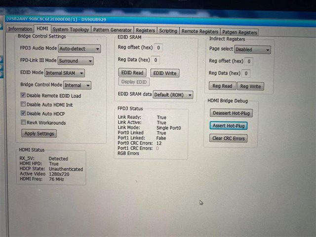

Our environment as above pic, I want to show my pc screen on the LCD.
The LCD is 1920*360, and we fail to show pc screen on LCD.
I can show color bar on LCD by use pattern generator on 929EVM.
Above pic is the setting in ALP HDMI page.
The active video show 1280*720, it's not fix to our LCD, any setting need to change?
Or there are any register need to set?

Hello, what the Information Lab appears the detected input HDMI information, that can't change.
You could change the LCD resolution, doesn't it ?

Is the bottom-left corner is information Lab? It's show ALP Framework - Hardware Connected.
Our product LCD resolution is 1920*360, couldn't change.
1. I success to use pattern Generator and change the resolution on 929EVM pattern Generator tab. I can show color on LCD.
2. I fail to use PC HDMI input on 929EVM and show the PC screen on LCD.
My question is any setting need to modify when use HDMI input?

Hello, there is no idea to change input HDMI resolution on DS90UB929 side.
For example, PC connected the UB929, if we want to change the input resolution, we should change the PC resolution as the above image listed. There is no related configuration of UB929 to change the input resolution.
If you want to write assigned EDID to internal SRAM, you can use both EDID_SEL & REM_EDID_LOAD in mode_sel0/1 ( can use either strap or register setting) to choose the EDID from internal SDRAM, in this way, your HDMI source can read this assigned EDID through DDC. Detailed solution as below:
