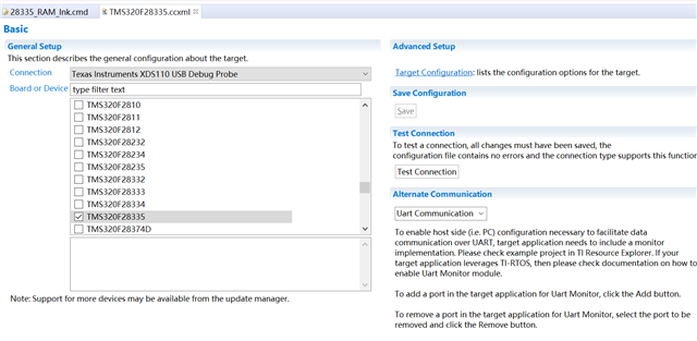

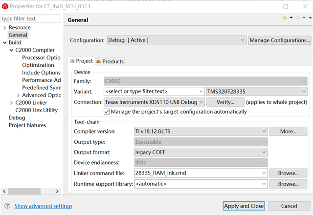

你好,
仿真环境为matlab2018a,CCS9.3.
Simulink配置参数如下:
Build结束时,报错如下:

"### Invoking postbuild tool "Download" ..."
C:/ti/ccs930/ccs/ccs_base/SCRIPT~1/bin/dss.bat C:\PROGRA~3\MATLAB\SUPPOR~1\R2018a\toolbox\target\SUPPOR~1\tic2000/CCS_CO~1/RUNPRO~1.JS C:\PROGRA~3\MATLAB\SUPPOR~1\R2018a\toolbox\target\SUPPOR~1\tic2000/CCS_CO~1/F28335~2.CCX ../CF_4wD_VCU_0513.out
*** User inputs:
Target Configuration: C:\PROGRA~3\MATLAB\SUPPOR~1\R2018a\toolbox\target\SUPPOR~1\tic2000/CCS_CO~1/F28335~2.CCX
Program Name: ../CF_4wD_VCU_0513.out
Board Name: unspecified (connect to first board)
CPU Name: unspecified (connect to first CPU)
*** Starting debug session...
*** Debug Session Name: Texas Instruments XDS100v1 USB Emulator_0/C28xx
*** Board Name: Texas Instruments XDS100v1 USB Emulator_0
*** CPU Name: C28xx
*** Connecting to target...
SEVERE: C28xx: Error connecting to the target: (Error -151 @ 0x0) One of the FTDI driver functions used during the connect returned bad status or an error. The cause may be one or more of: no XDS100 is plugged in, invalid XDS100 serial number, blank XDS100 EEPROM, missing FTDI drivers, faulty USB cable. Use the xds100serial command-line utility in the 'common/uscif' folder to verify the XDS100 can be located. (Emulation package 8.4.0.00006)
SEVERE: emulation failure occurred
SEVERE: Error connecting to the target: emulation failure occurred
SEVERE: Cannot perform operation, target is not connected.
SEVERE: Error reseting target: Cannot perform operation, target is not connected.
org.mozilla.javascript.WrappedException: Wrapped com.ti.ccstudio.scripting.environment.ScriptingException: Error reseting target: Cannot perform operation, target is not connected. (C:\PROGRA~3\MATLAB\SUPPOR~1\R2018a\toolbox\target\SUPPOR~1\tic2000/CCS_CO~1/RUNPRO~1.JS#93)

其中核心报错部分黄底标出,我试过matlab2018a+CCS10,也报一样的错误。但我同事用同样配置的电脑同样软件环境build就不报错。请大神指点。谢谢
